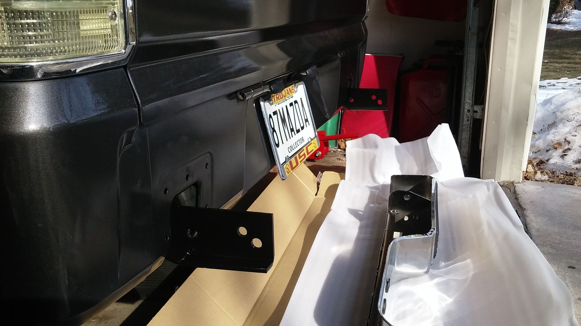

Bolt the Fey/Westin 95800 brackets onto your frame. This is the easy part.

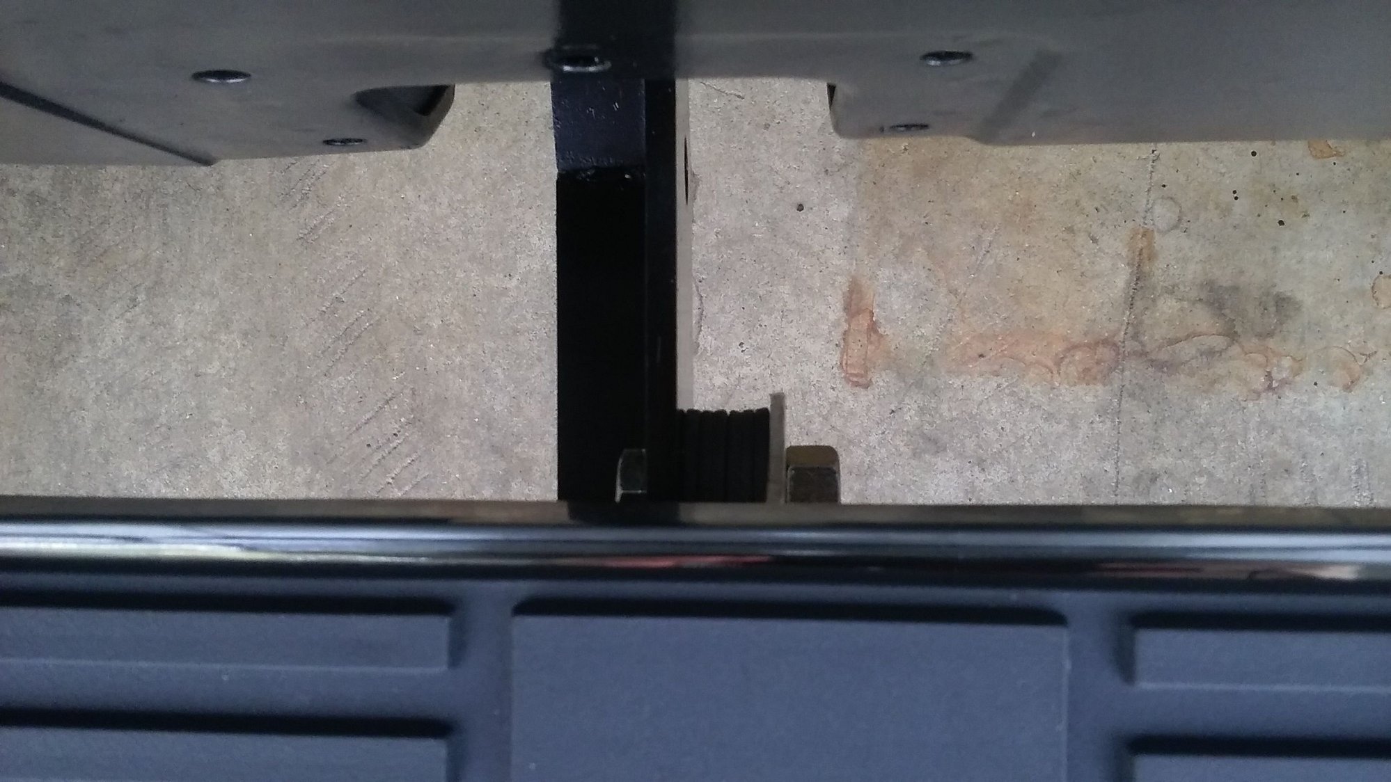

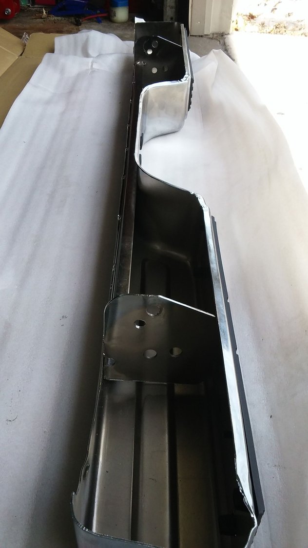

You will be using those two holes that are close together at the end of each bracket. Attach the bumper temporarily to the top hole with one bolt on each side. I used 6 washers on each side to make up the gap between the 43-in frame width of the Mazda truck and the narrower, 41.5-in gap in the bumper's attachment "fins." Tighten them just snug so that you can swivel the bumper up and down with a little effort. Using a level, measure the bubble position of the bed main body line on the side of your truck bed. Swivel the bumper to be parallel to that line -- the position of the level bubble should be the same as it is with the main body line of your truck bed. With a sharpie, mark in the other hole through the Fey/Westin bracket where you're going to drill a 1/2-in hole in the Toyota bumper attachment "fin." I started with small drill bits first and kept working my way upward to finally get to a 1/2-in hole. Here's what the bumper looks like after you drilled the two holes.
Old Mar 8, 2021 | 04:40 PM
The Lizard King's Avatar
Joined: Aug 2020
Posts: 201
From: Minneapolis, MN
Notice that the hole you drill will be smaller than the hole that came with the bumper. As long as your bolts that came with the Fey/Westin bracket set go through the hole you just drilled, you're good to go. Now, just bolt it up using the lock washers and nuts provided. Use washers (again I used 6 on each side) to make up the gap on each side between the bumper and the Fey/Westin brackets. The amount you use will depend on the thickness of the washers. I found a jar full of random washers on my work bench, so I just used those.
