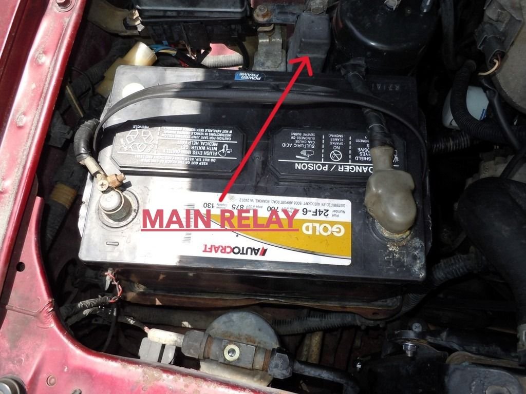

David solved his issue and posted it on a different Mazda forum (one for these trucks only) .......turns out it WAS the Main Relay in the engine compartment. I figured I would let others on this forum know the solution to his issue.

Where is the main relay located in the engine compartment? How does it look like?
I have had the same problem with my b2600i . It runs 20-30 secs and then stops. After waiting for 10-15 mins you can repeat the same procedure.
