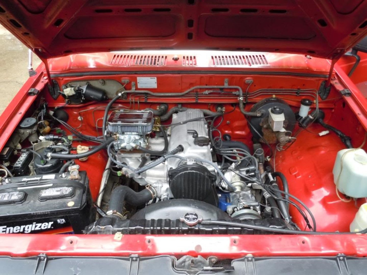

So, if it runs great, don't touch the carb or the air intake system.......just drive it and enjoy it. You won't gain ANY more horsepower by installing a cold air intake system. When the factory carb is operating as it is supposed to, it gets good mileage for the truck......however, when it starts messing up, then it is a nightmare to troubleshoot! Once that happens, I just swap out to a Weber 32/36 carb with electric choke, and remove all of the vacuum hoses, remove the exhaust manifold, and put a Pacesetter header on it.
But again.......if it runs good with the factory carb.....keep it stock! It will save you some money, and you will enjoy the truck more! If you hold onto it long enough to where the factory carb starts having issues, that would be the time to start changing things around some.
And BTW....no one make a cold air intake system for a carbed B2200.......if it were EFI, then you could probably buy a universal system that would work.
Here is what mine looks like after a Weber swap and adding a Pacesetter header.......no cold air setup either, just an open element air cleaner setup.....any cold air setup won't help a 90 hp engine much!
