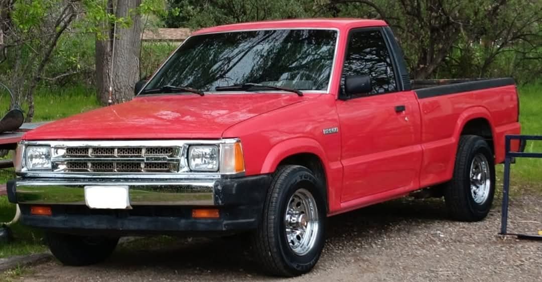

Keep us posted on what you find out please. BTW.....that's a very nice looking B2200 truck you have there!
