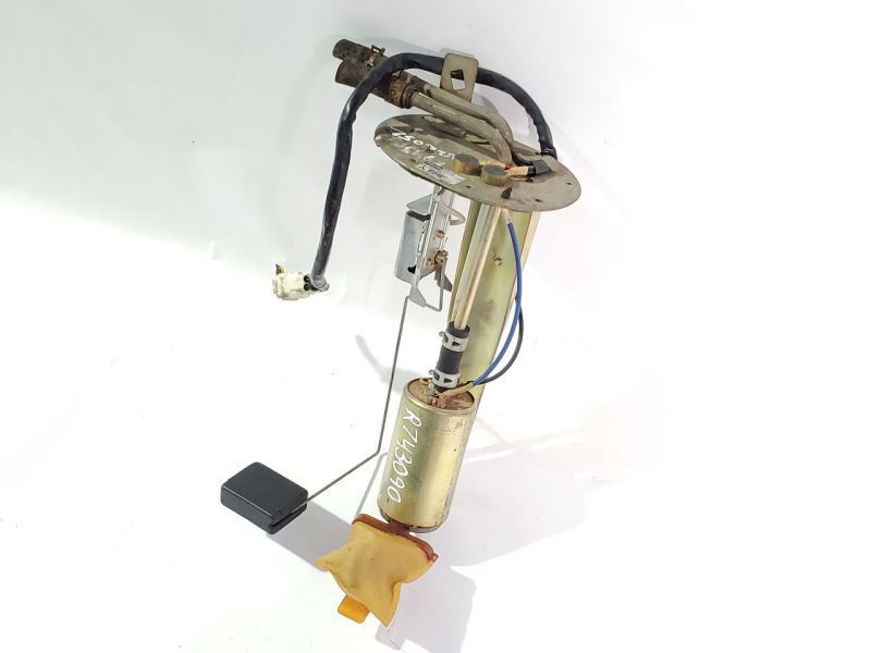

Here is a used Mazda unit on Ebay.....

is this the one for 349? I can only find one for that price and since I have a new fuel pump I will replace my feed lines that are rusted out on my unit for that price since I only paid 300 Canadian funds for the whole truck. That’s an insane price for a used unit imo. That does look exactly like mine though
Mine actually looks different and has an angle instead of straight down

I had to rebuild mine as there are none available in North America apparently. I also covered all the terminals in seal all just as a precaution. If anyone is in the same boat as me I highly encourage to just rebuild yours as it is simple and basic. Just drill out the old lines and bend some new ones. Lots of room above the tank and angles are as critical as u can simply run longer rubber hose.
