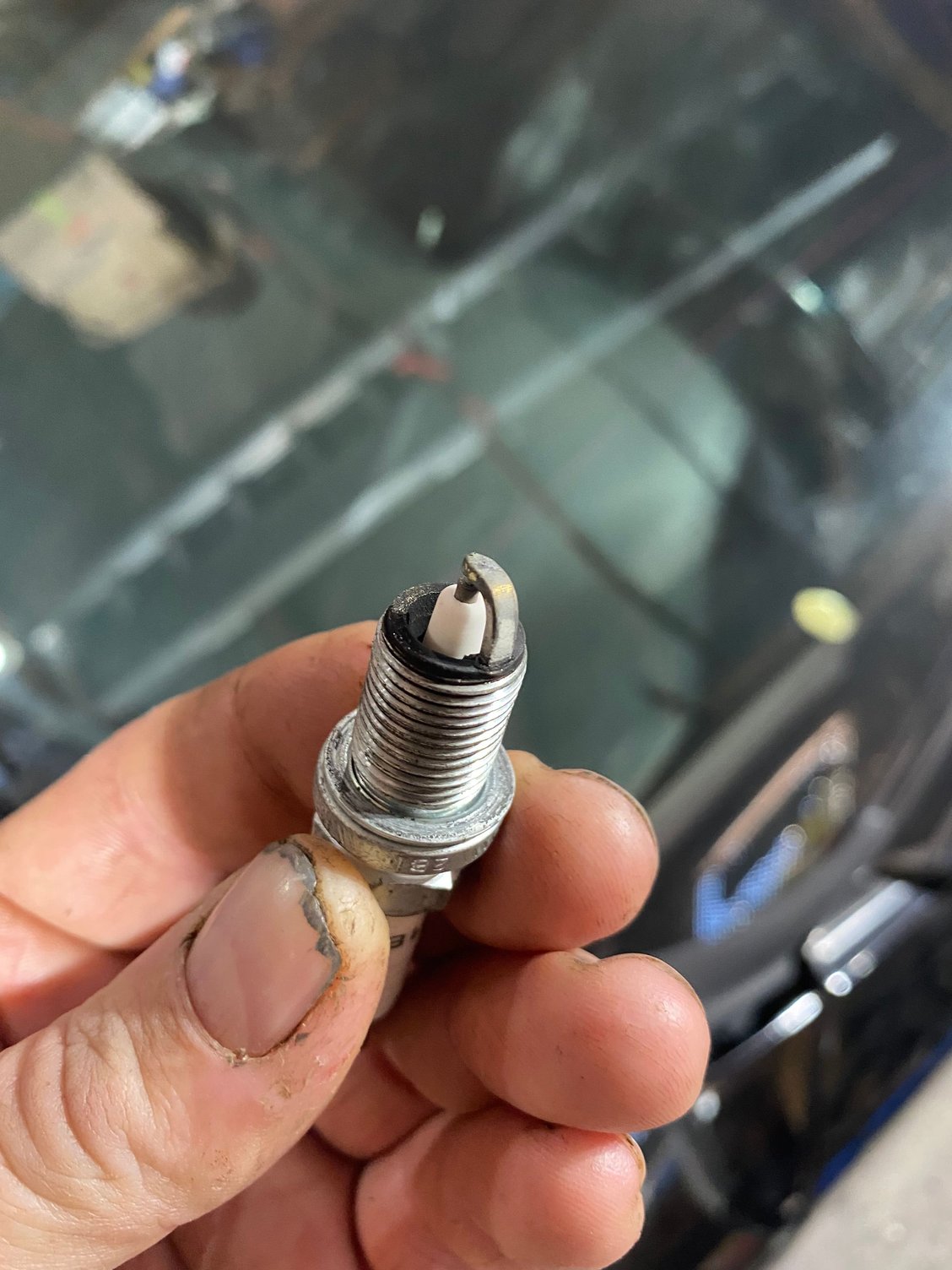

Also plugs shortly after changing them
Plugs shortly after changing. Def not running rich

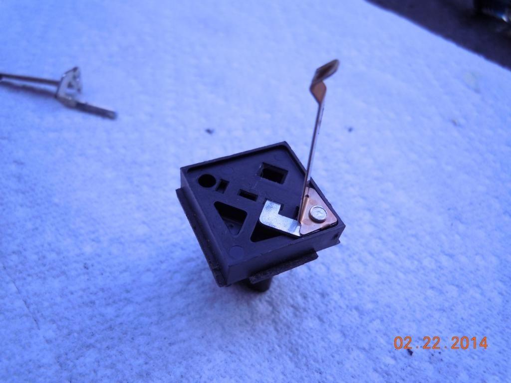

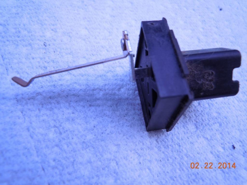

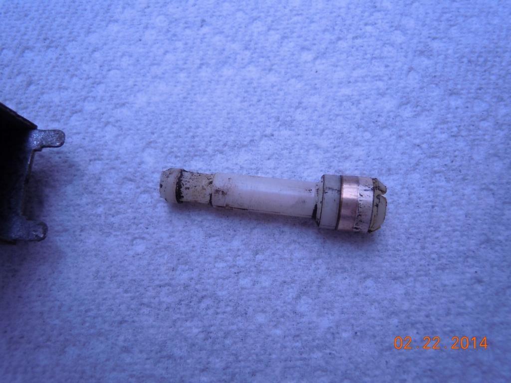

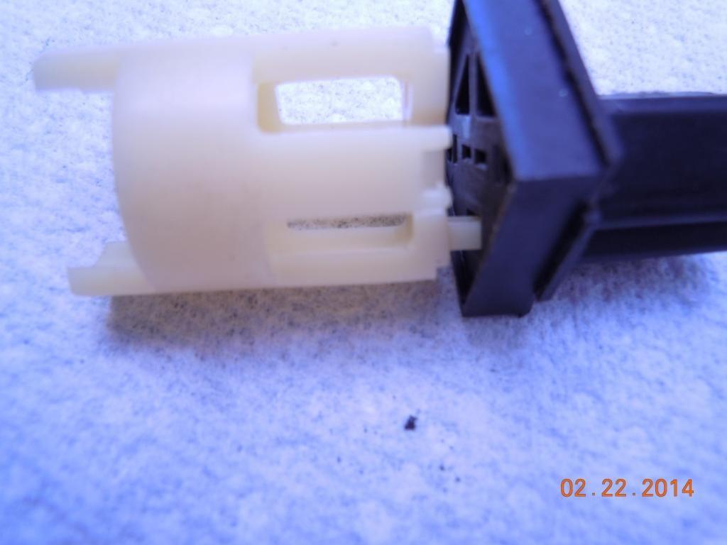

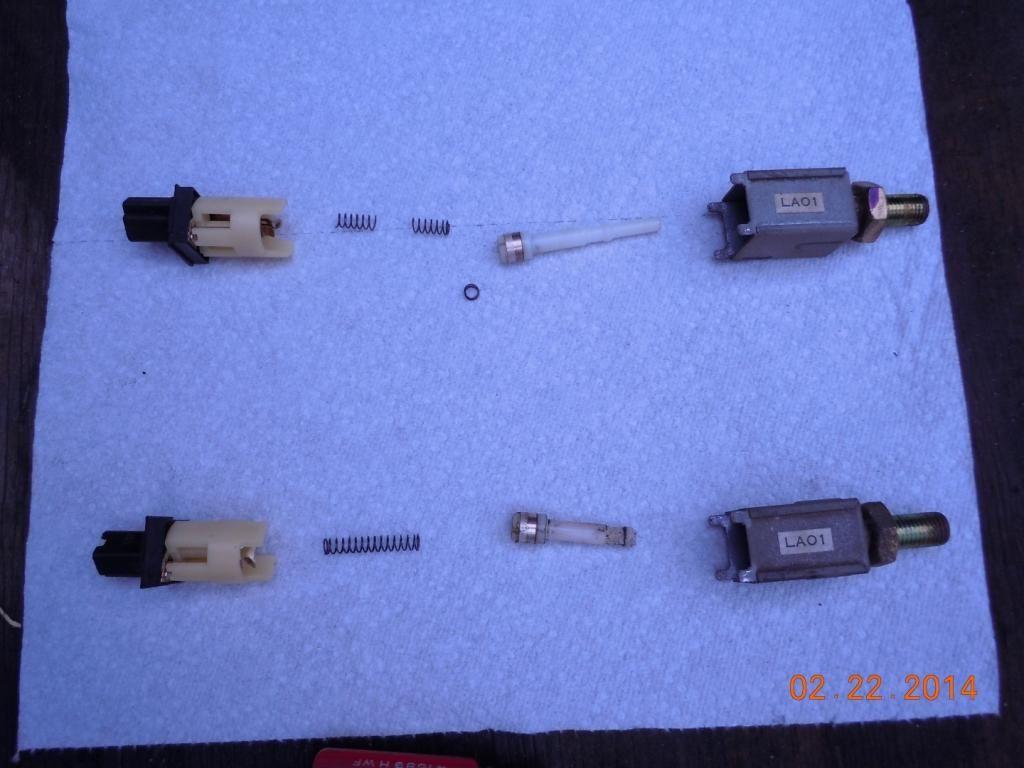

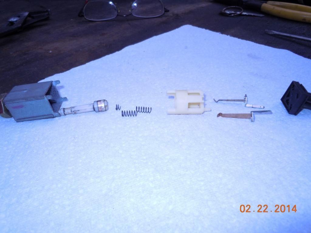

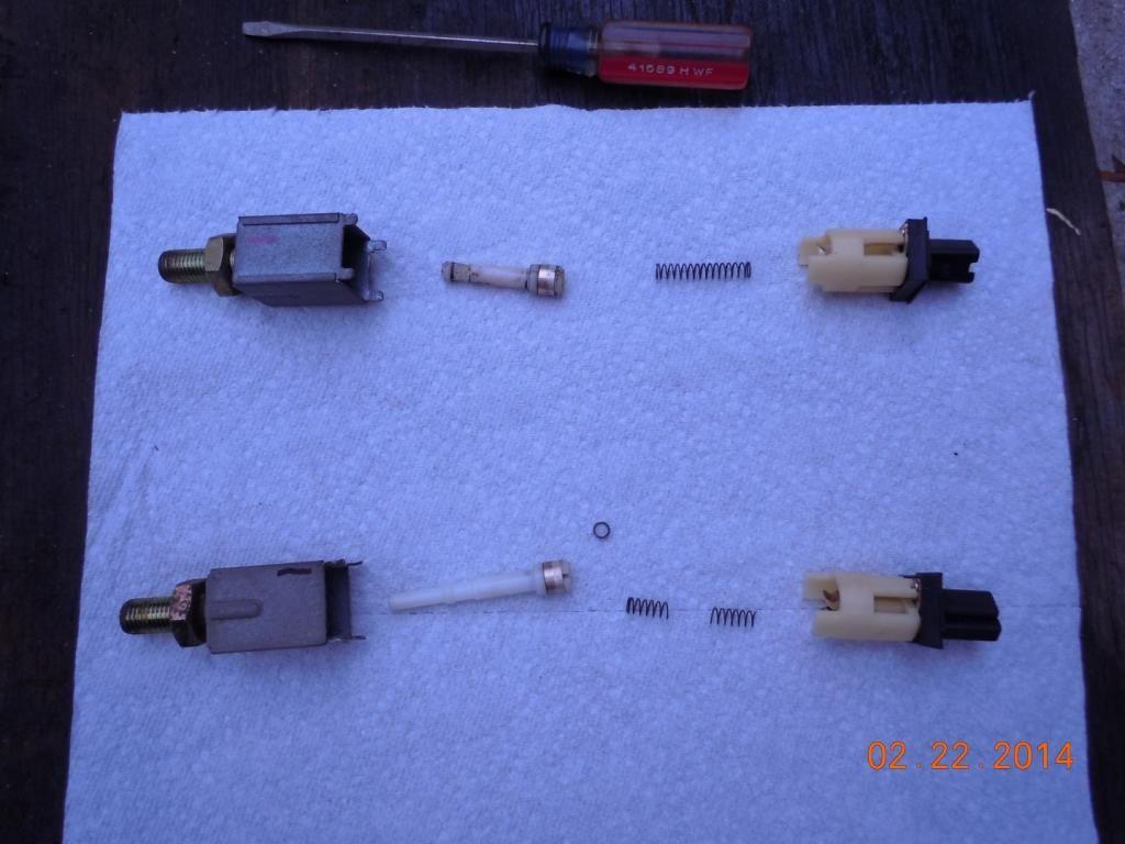

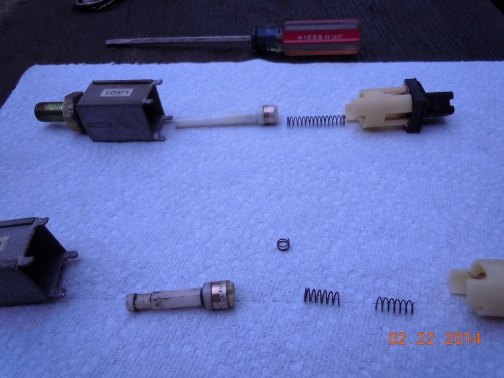

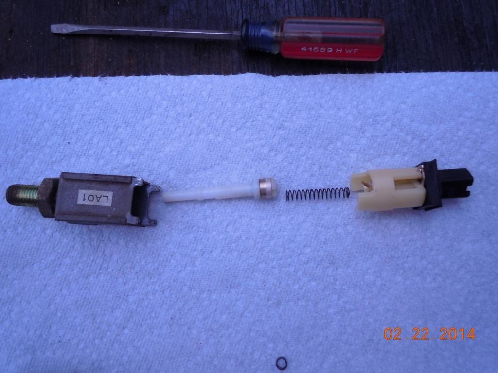

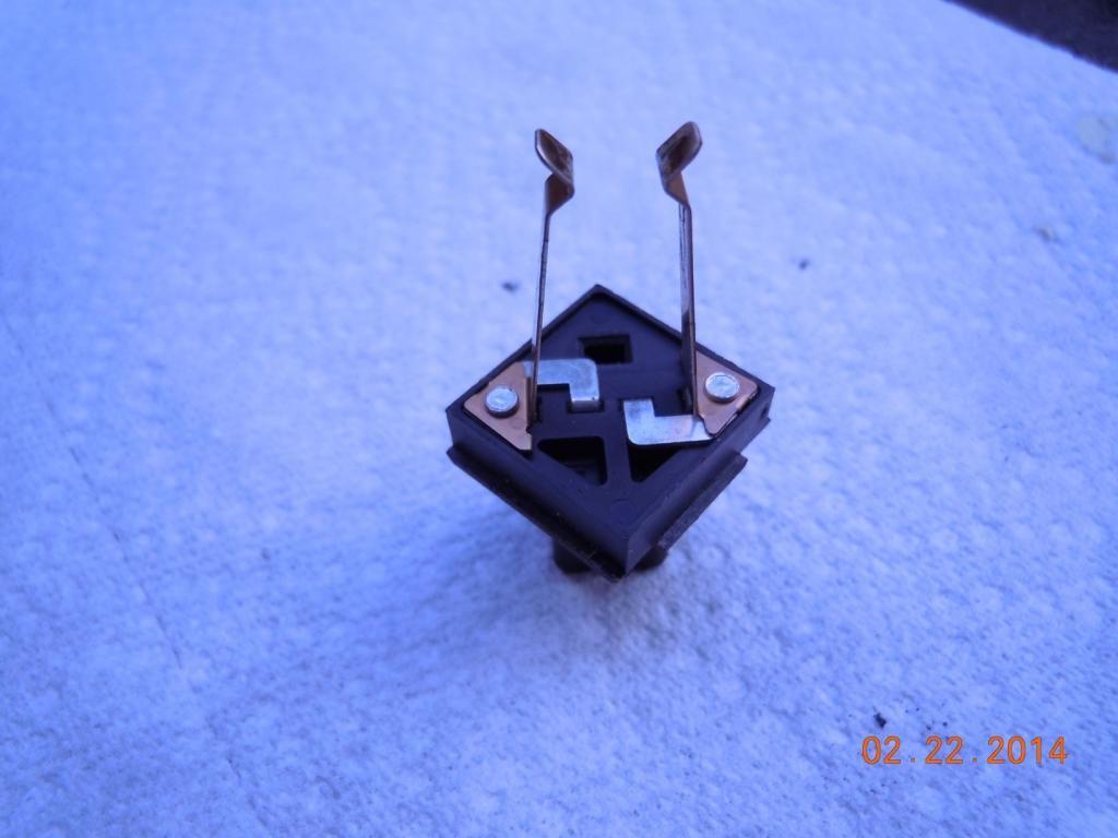

OK......here are some pics of 2 broken Clutch Switches.......one switch has a broken plastic plunger......the other one has a broken return spring! I disassembled both of them and by swapping the internal parts around, I made one GOOD Clutch Switch!
After swapping the parts around, I made a good working switch......after I re-assembled it of course!
If your plunger is not broken, but the spring is, you can probably find a new spring for it at the hardware store also.....
Like a lot of these original Mazda parts.....you can take them apart and fix the issues they have and return the part back into service again.......on the CHEAP!
