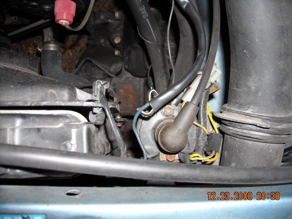

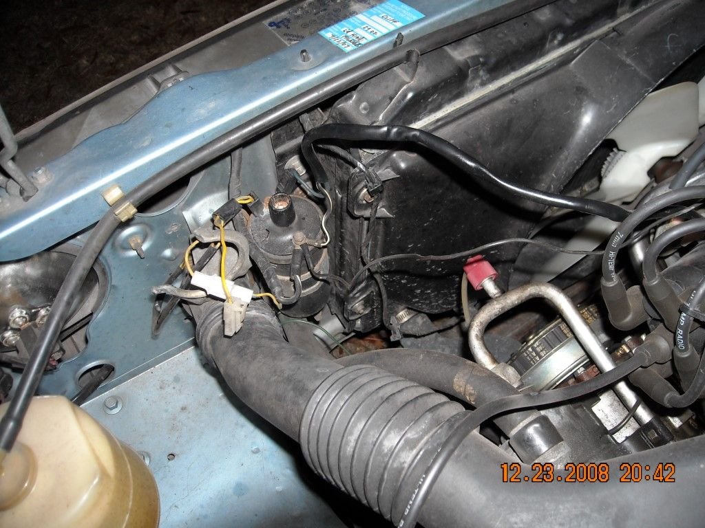

Old Mar 23, 2021 | 12:34 PM
MeB2000's Avatar
Joined: Aug 2009
Posts: 649
Likes: 34
From: North Central Florida
Here is a picture of how the coil should be wired......
Old Mar 23, 2021 | 01:16 PM
Lesscline's Avatar
Joined: Jul 2018
Posts: 11
From: Helena mt
So the the third hot wire? Where does that go? Ignition, distributor, and....? Curious. Do you have picture of your where your grounds are by chance. End of negative battery cable? I bought a new coil and still no spark. Got a new distributor coming but I can't get any spark out of the coil. I'm thinking I missed a ground or have an open circuit somewhere
