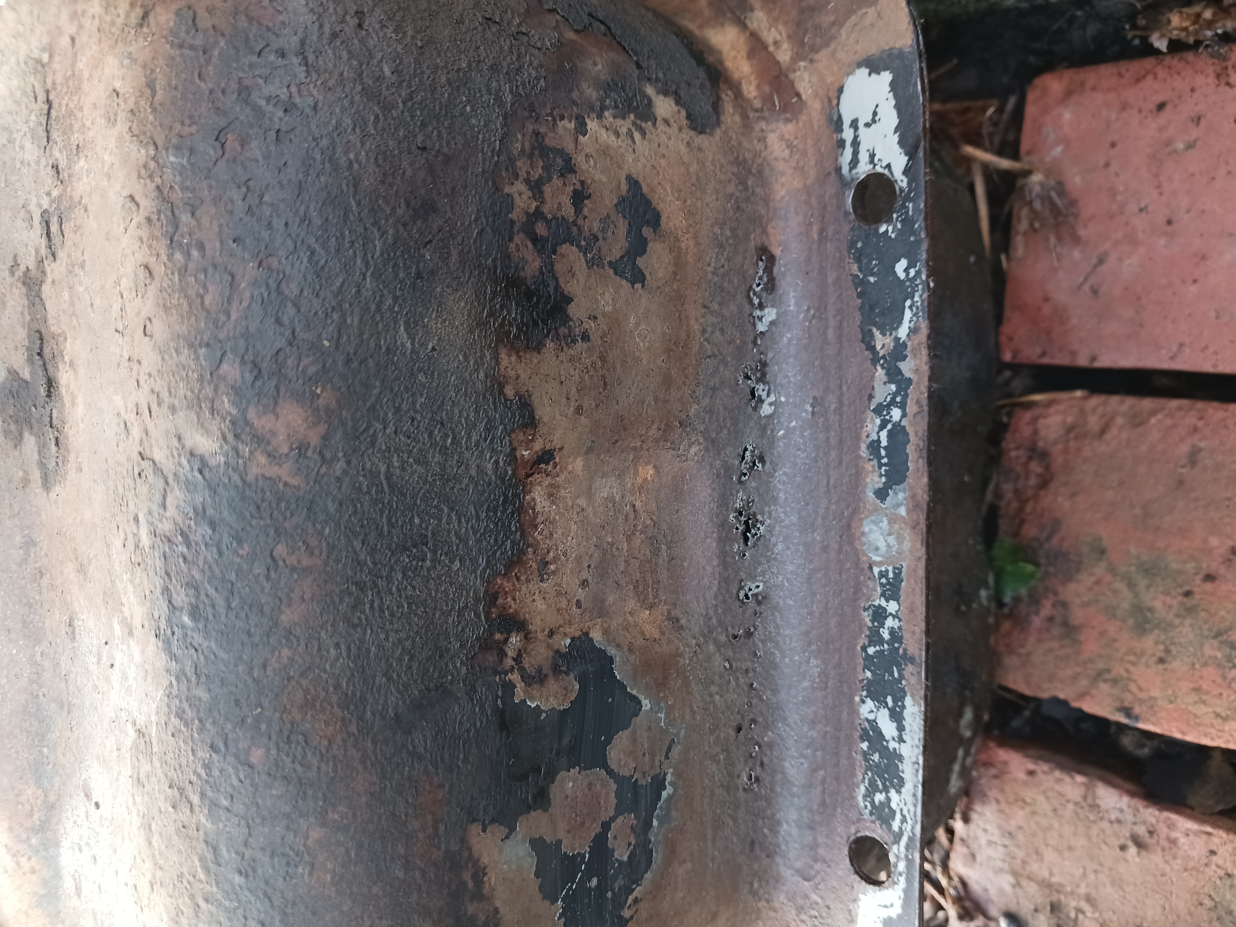

My 84 B2000 has a rust hole in the tank, right above the midline where it mounts up to the frame. I've tried tin tape, flex tape, and fuel tank epoxy, and every time the gasoline eats right on through. Looking up replacements, I've learned that Mazda obviously doesn't make them anymore, and Carpart shows me outdated listings. I looked into getting an 86, but those are mirrored so I'd have to move the exhaust and honestly just get a new bed.
As for repair: I've considered brazing and welding, but I don't really have the skill or money for that. Most recently, I've considered stamping some fuel-safe plastic on, like a clip out of a portable canister.
Random thoughts:
1. I don't weld, but have heard that experienced welders can weld a gas tank safely after filling it with water or nitrogen.
2. How big is the hole; can you post good pictures? I've heard of folks using a sheet metal screw and rubber washer to fix small holes.

1. The second welder I went to said that, the first told me the metal was too thin to work with. Either way, I never got around to actually doing it before I lost contact.
2. Only pic I have is before I knocked out the rest of the rust. It only shows as a couple pinholes, but it's like a 5x150mm gash.
3. I'm not super warm to the idea, considering it's only a 6' bed and I like to go stealth camping. The dune buggy fix, maybe; if I can make a carrier for it to keep it under the bed.
4. I don't remember exactly. Normal JB Weld the first time, and JB Tankweld putty the second time.
I actually remember hearing that Yugo filler necks were soldered on, and I do have the tools for that. Reckon that's worth a try?

I think that I would see if you could have a metal fab shop build you a new tank.......probably be twice what a new tank would cost IF they were made by some company, but as you have discovered, they are not. The metal fab company could make it to the exact dimensions, and reuse the fuel sender mounting plate that is on your original gas tank.
