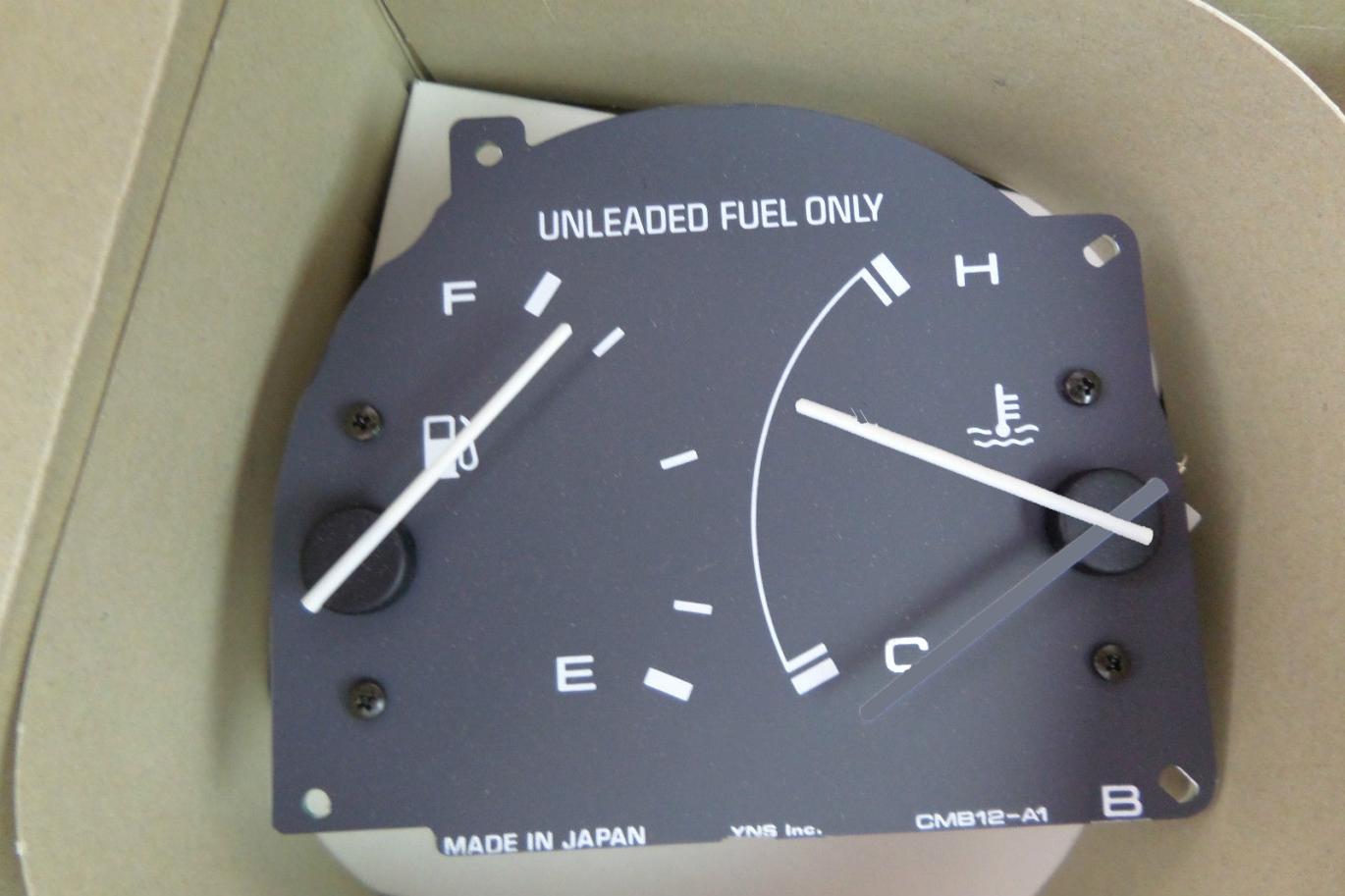

Does anyone have a BG 323 and could tell me where the temp usually sits?
Here's a picture to show where mine sits after a few minutes and stays.

thermostat the right way round?
my old fiesta, i replaced a valve and in the process damaged the temp sensor on the head. never had a temp reading after that, HOWEVER, when the cables got wet, temp needle went all over the gaff.
maybe your wires are giving up? a small short somewhere, or poor contacts, or wet?

the gauge on your dashboard is not a true value of the temperature, rather, the temp sensor gives out a voltage which is dependent on heat. this voltage is what is displayed on your dash. so when my wires were knackered on the sensor, having them wet would give a false reading.
to clarify, the temp gauge on the dash and the temp sensor ARE NOT thermometers. check all the connections.
