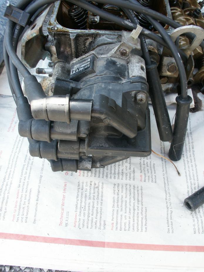

Ok as requested here is a picture of the dizzy. The central plug is just a breather, no wire is hooked up to it.

The housing doesn't look big enough for either a built-in (on) coil, or a magneto?
I am confused.
Another confusion is the "breather" you mention. Traditional distrubutors want to be sealed from dirt and moisture. I once bought a cap that must have had a hairline crack in it from the factory. I never could see or even find it. It was that small. But when the hunidity was high the car wouldn't start until I took it off, dried it out with a towel and sprayed it down with silicone. I replaced the cap and no more problems.
Another question: Does the distributor require an outside power source? Is there a 12v lead going to it?
A magneto, basically being a high voltage, low current generator and producing its own power as the engine turns it would not require another power source. It might have an auxillary ground wire though most of the grounding would come from the engine head or block since those too are grounded.
