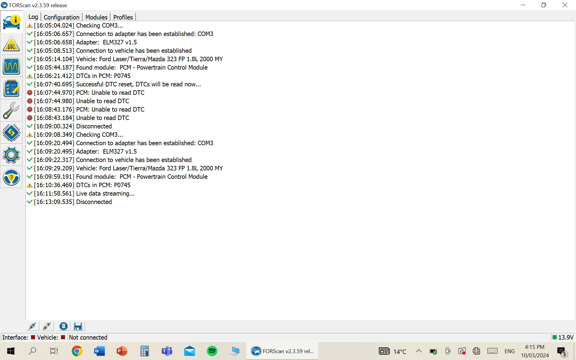

Update time...I purchased a cheapo elm327 USB reader from amazon and tried again with the PC version of Forscan (via the 17pin diag port). This time I was able to get a single DTC from the vehicle ...P0745 EPC circuit fault. This is further than I got using a handheld scanner or a Veepeak bluetooth scanner with Ios App.
