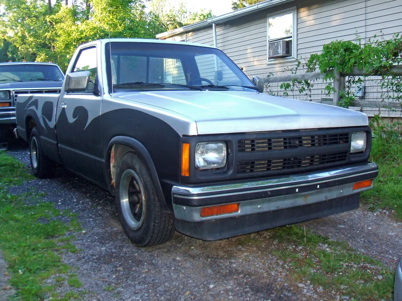

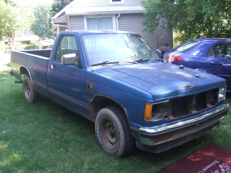

Shall I post my rides?
This is a project truck I paid 200 dollars for, I think my total build cost is like 450-500 now

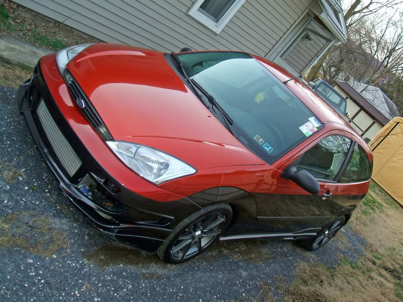

I built a focus awhile back, kinda fun but needs some love.

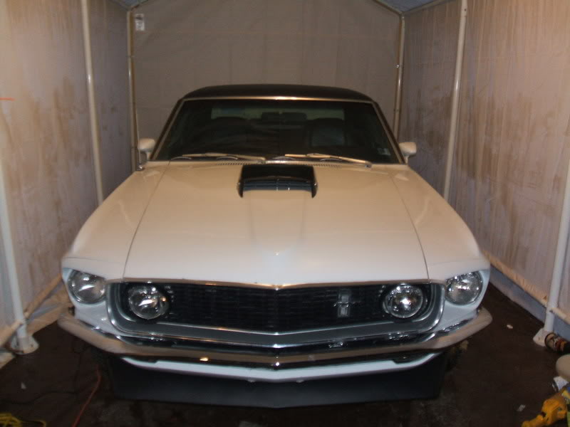

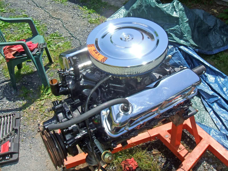

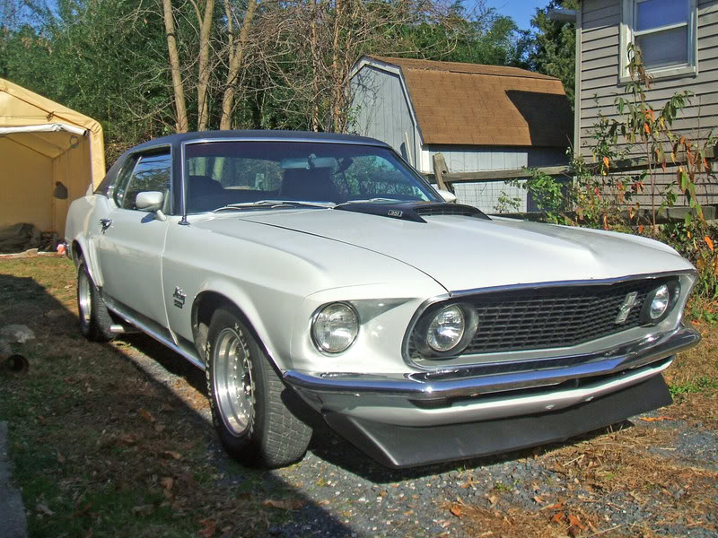

Heres our mustang we got a few years back, was in great shape but was a bit neglected. Brought it back a little.

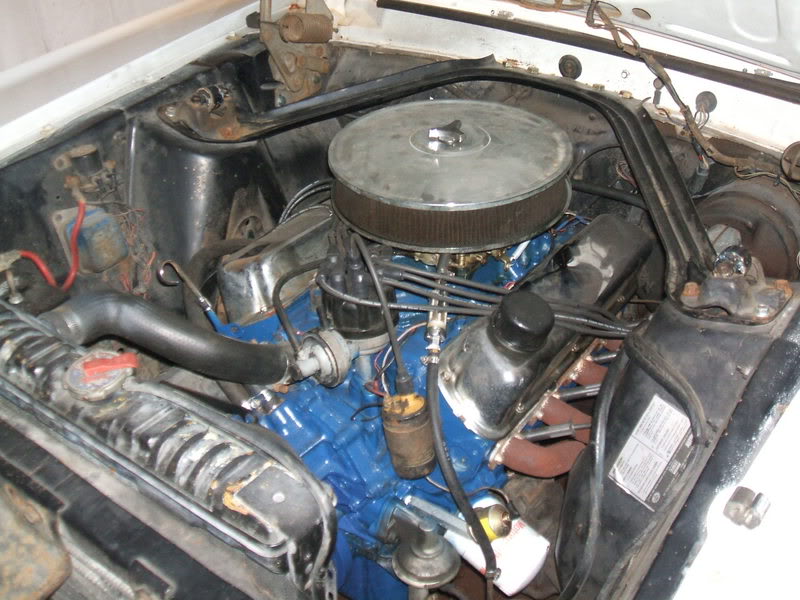

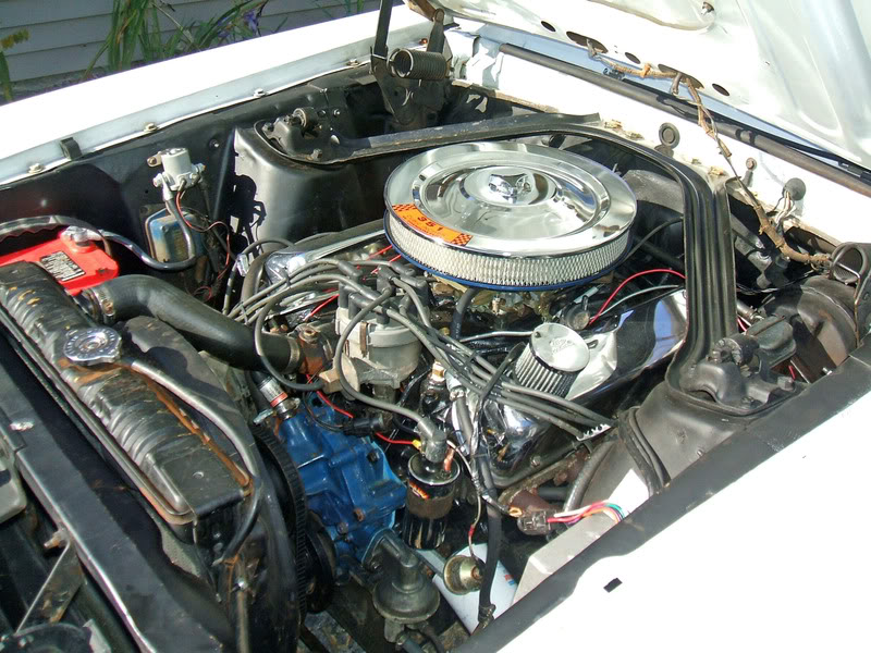

Heres a before motor pic
