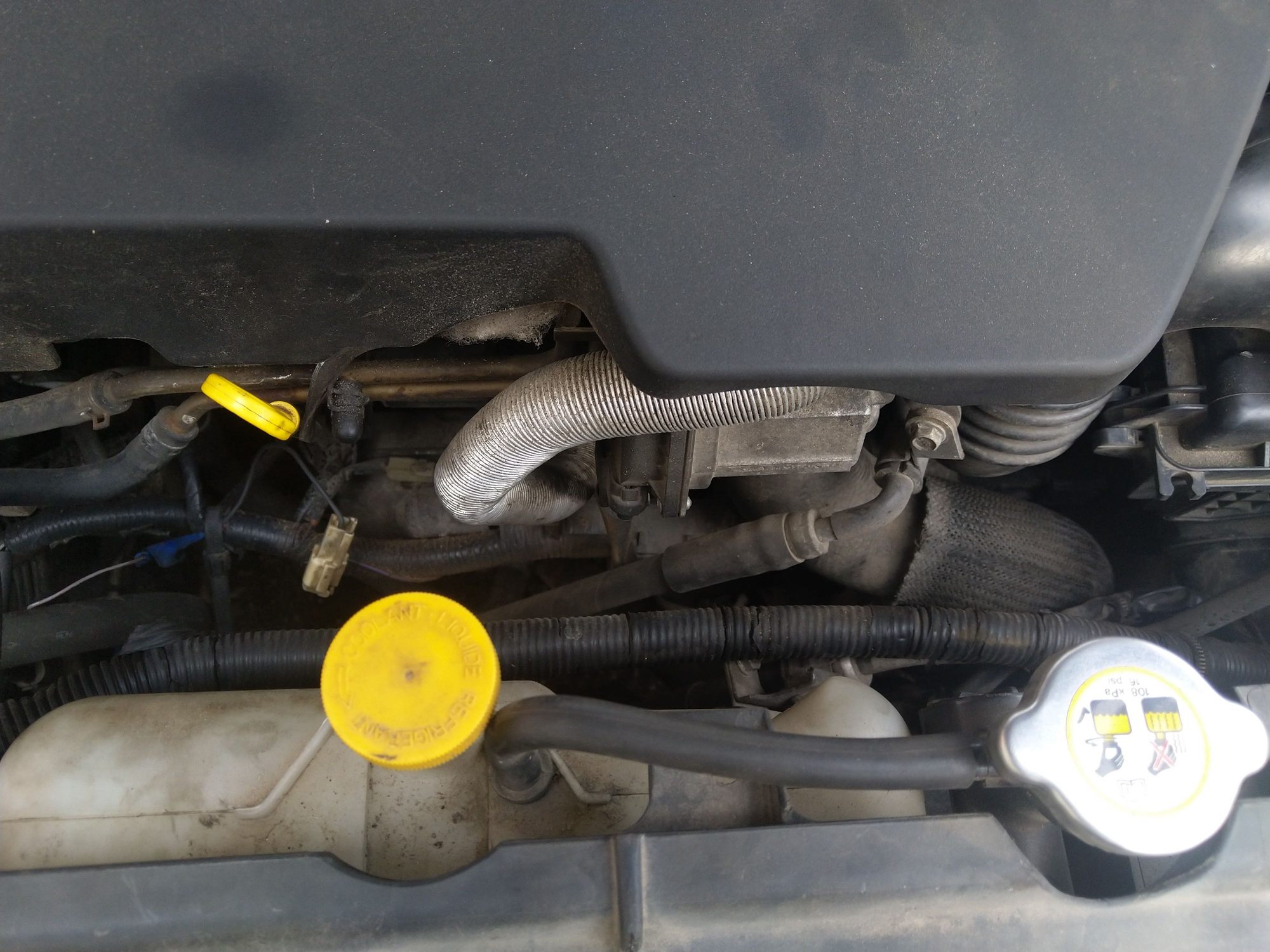

the main belt and the bearings is on the list to replace to. Also interesting connector near the radiator, still could not find a pair where it should be connected, and that it is anyways?

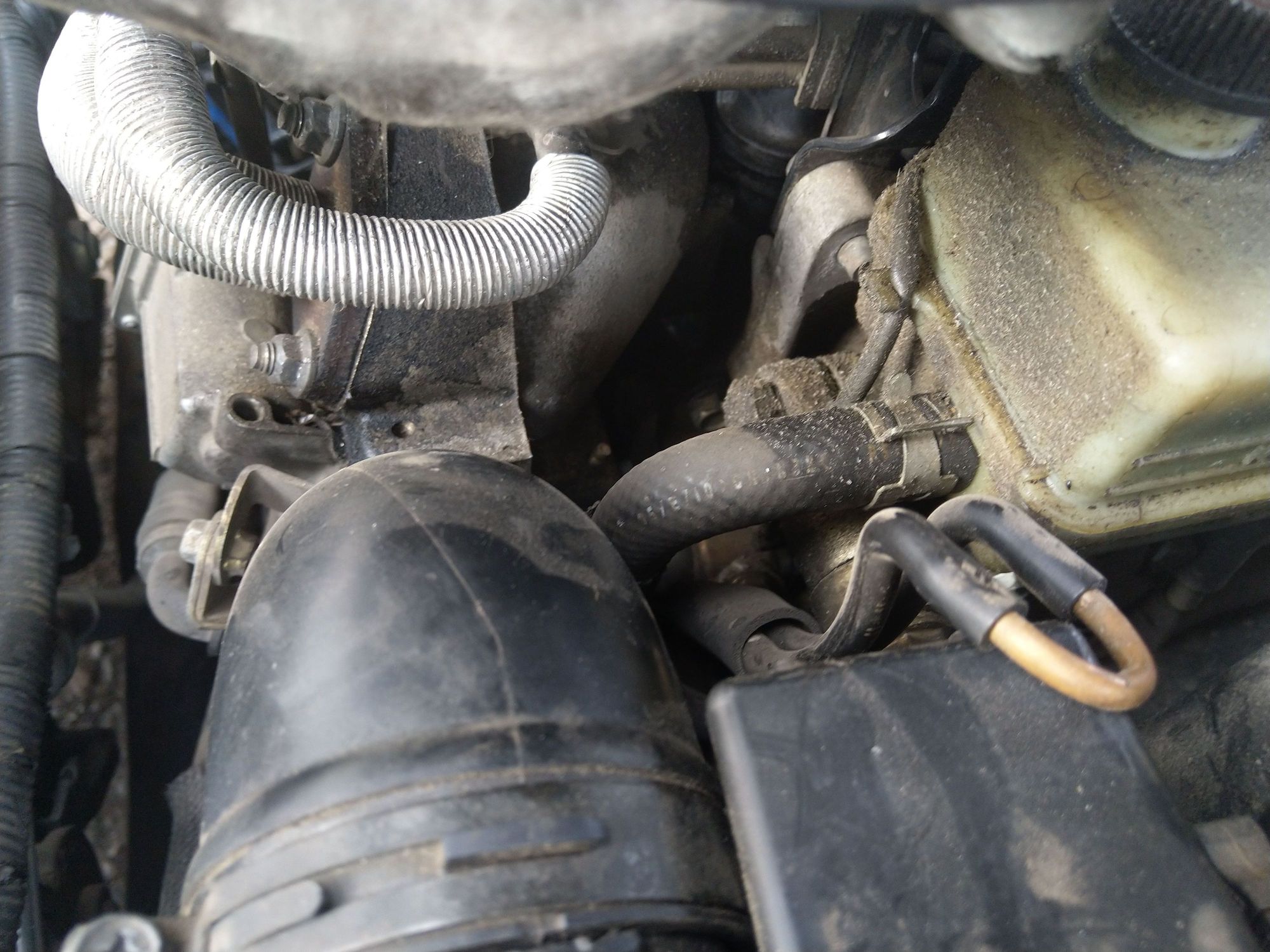

This is the loop that should go the the air filter but instead made a coppoer tube

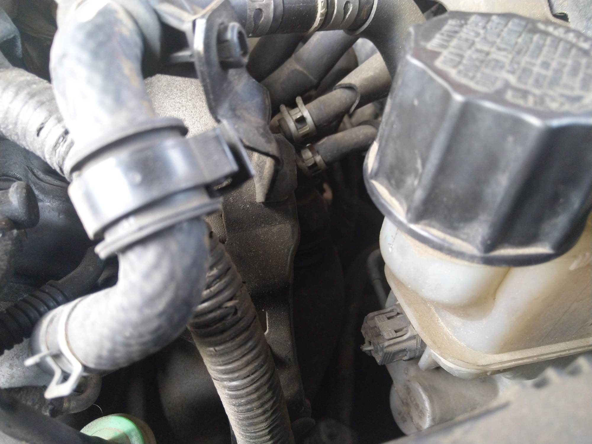

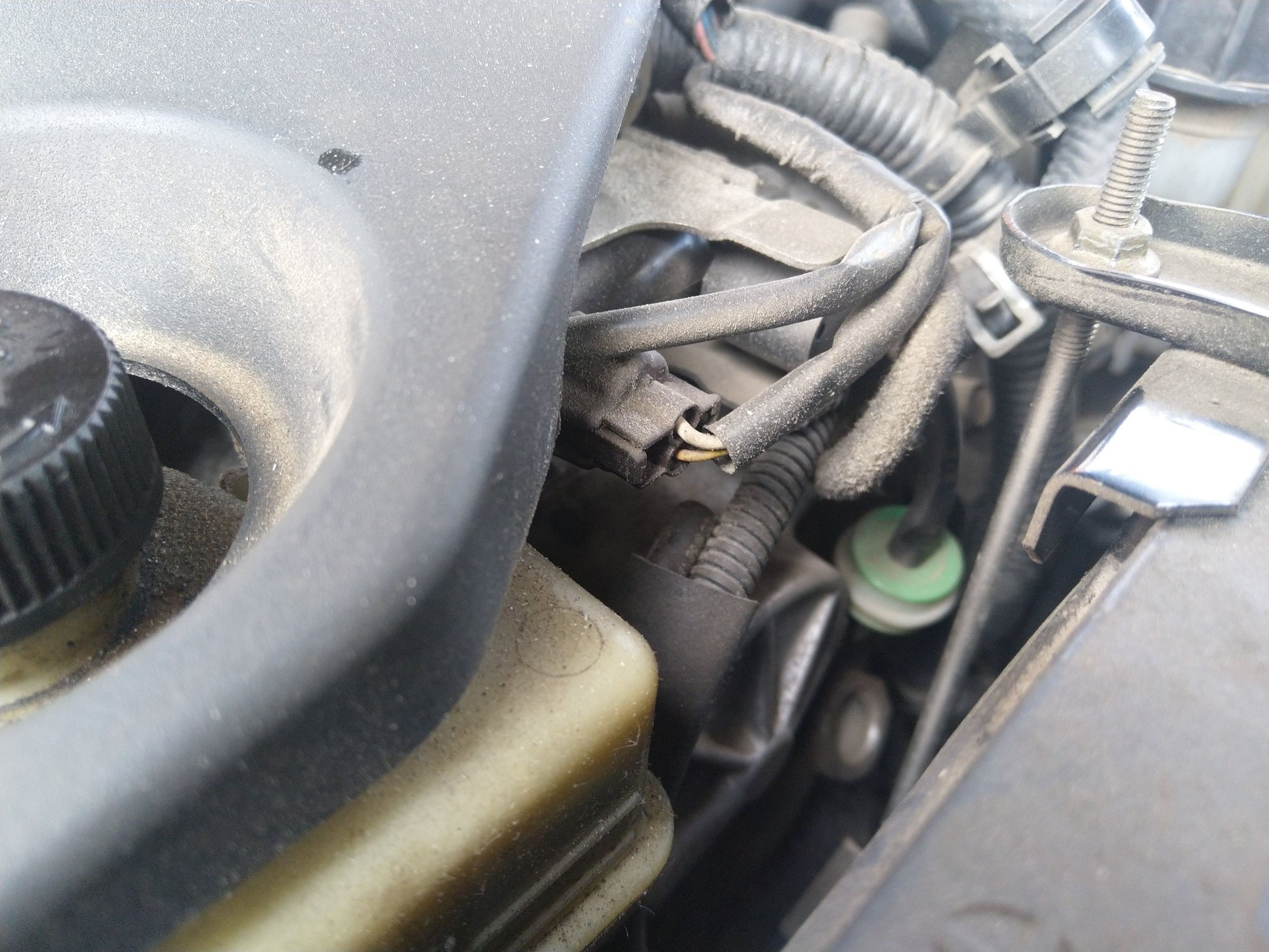

This is the longer one and the very bottum is the second one that should gosomewhere but it is disconnected...

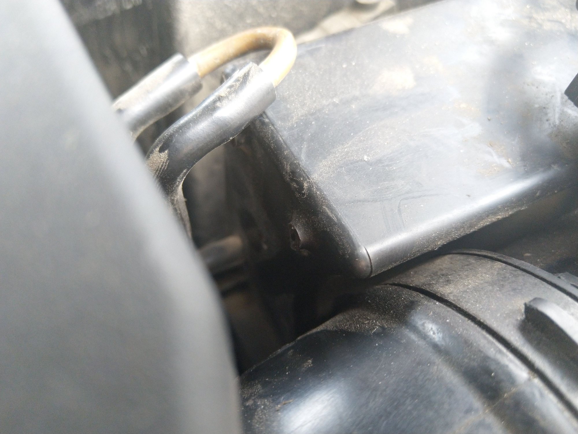

other angle

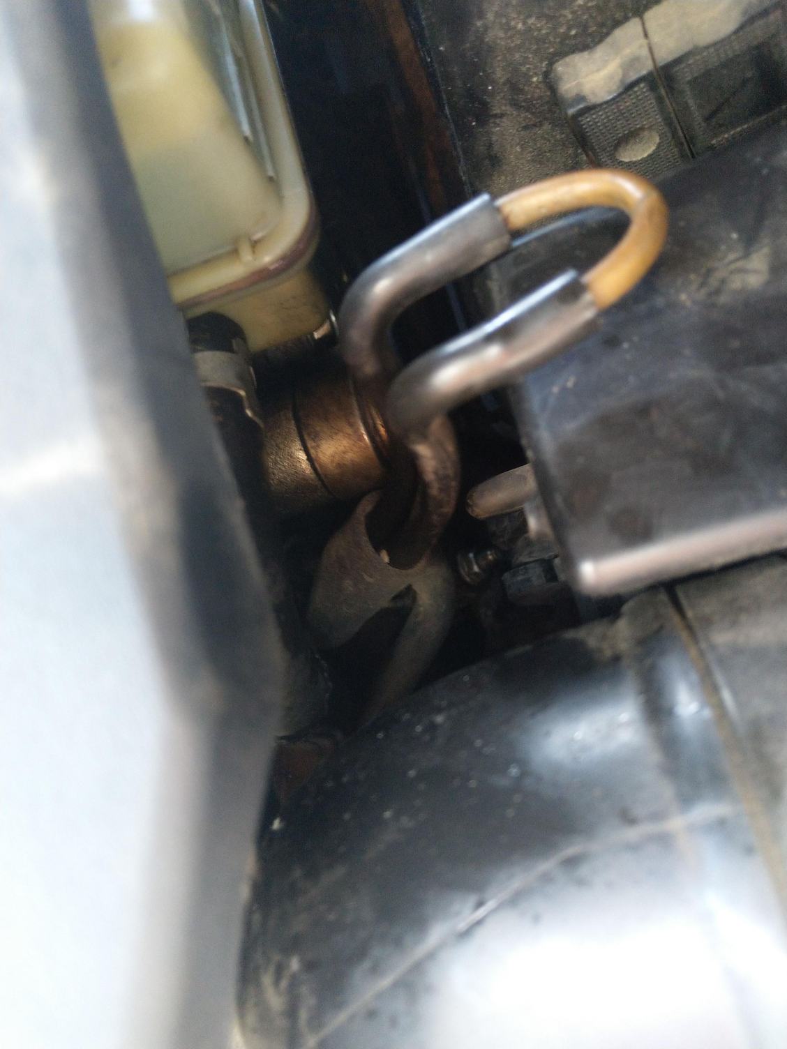

Take a good look, there is disconnected connector that should go to a upper right od the yellow cap near the silver tube.as i investigated that is EGR, maybe it is deleted? should i remove it and make a good clean, if it is deleted then remove the deletion gasket and replace with a good one. EGR deletion is not my favorite thing on the car.

Same loop seen in other photo
the connectors are compeltely broken off but i was assured that this is only a closed loop inside so this is allowed to make a loop like that instead and everything should still work
take a look at the vakuum pump and how the hose goes over it...

Then poked to the EGR test as a very basic test, to my surprise that one failed, Then opened the hood to take a GOOD look for a loose vakuum hose(s) and found interesting thing, the Vacuum pump was not even connected, loose hoses hidden under the bigger ones. Got that sorted out when i found ascheme how it should be connected. In other forum the guy who looked at the mess that has bin made in the car told me that the two top ones that goesto a air filter box is not important, if they are with a loop connected in-between then it should work perfectly. And mine is connected one with each other with a copper tube.The tube is also not perfet so i am planning to completely replace the hoses to a new ones and eliminate the possibillity of ANY fail in this part of the system.To my surprise the power did not come back after reconnecting the vacuum pump as it should.

next thing is there is a thought that the Air Filter housing that has broken off connectors, and the vacuum hoses that should go in to the air filter is just made a small loop, connected with each other. Some tell that in the air filter housing there is just a vacuum chamber, same as the loop that is made and there should be no difference , but something inside of me tells me that japan engineers did not make a simple loop inside of air filter just like that. This should be douing something but i cannot find any schematics explaining this section of the vacuum connections and the schematic of the air filter housing itself. There should be 3 small ***** for the vacuum hoses at that place. But there is non and also i can find only two hoses comming to it so somewhere there is a pretty huge vacuum leak if the third hose is the part of this and it doesnt exist at the place that it should...
