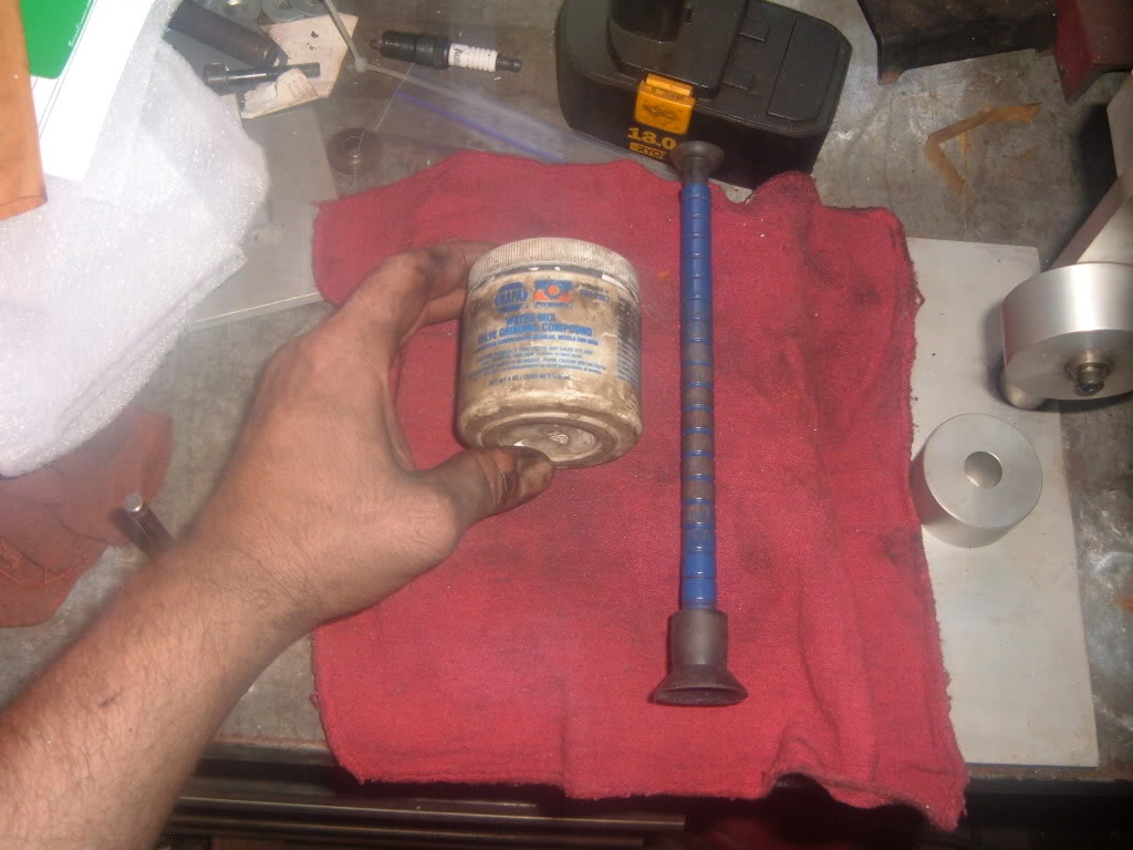

The tools needed will be a lapping tool and valve lapping compound.
There are different brands, grits and bases. Even colors.
I use permatex water base fine grit. Grey in color.

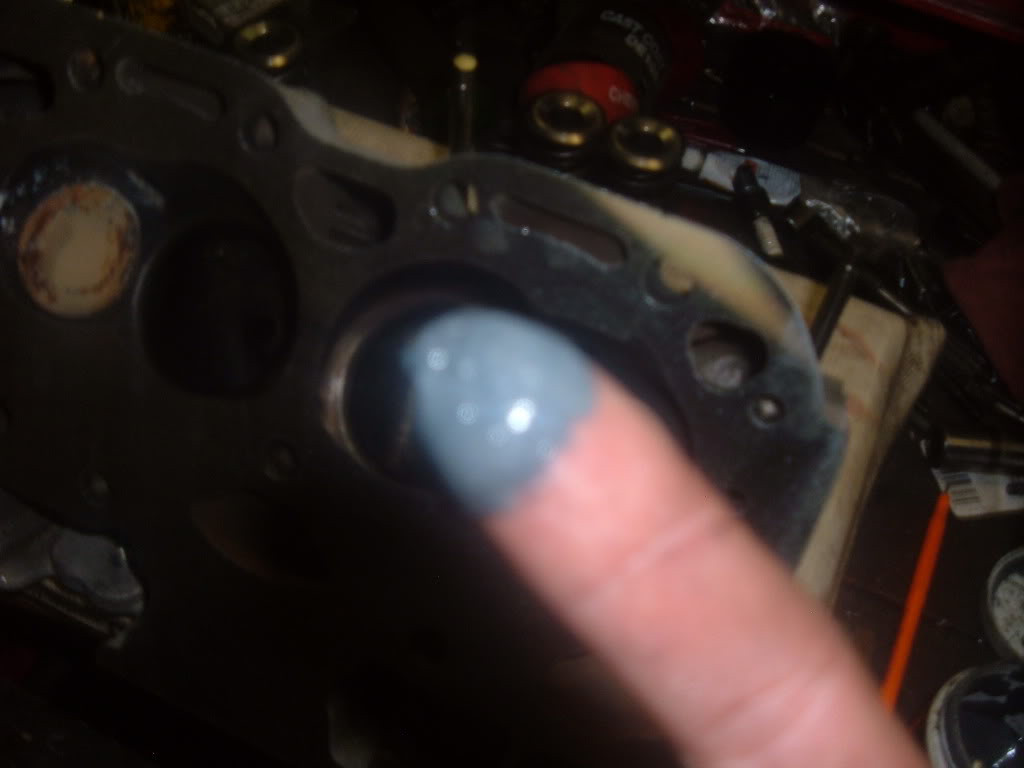

Place a fair amount on your finger tip.

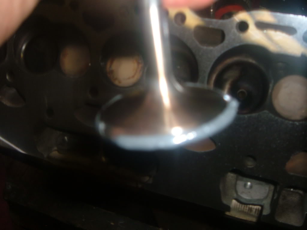

Then bead it around the valve face.

Next is slide the valve back down the guide and seat the valve.

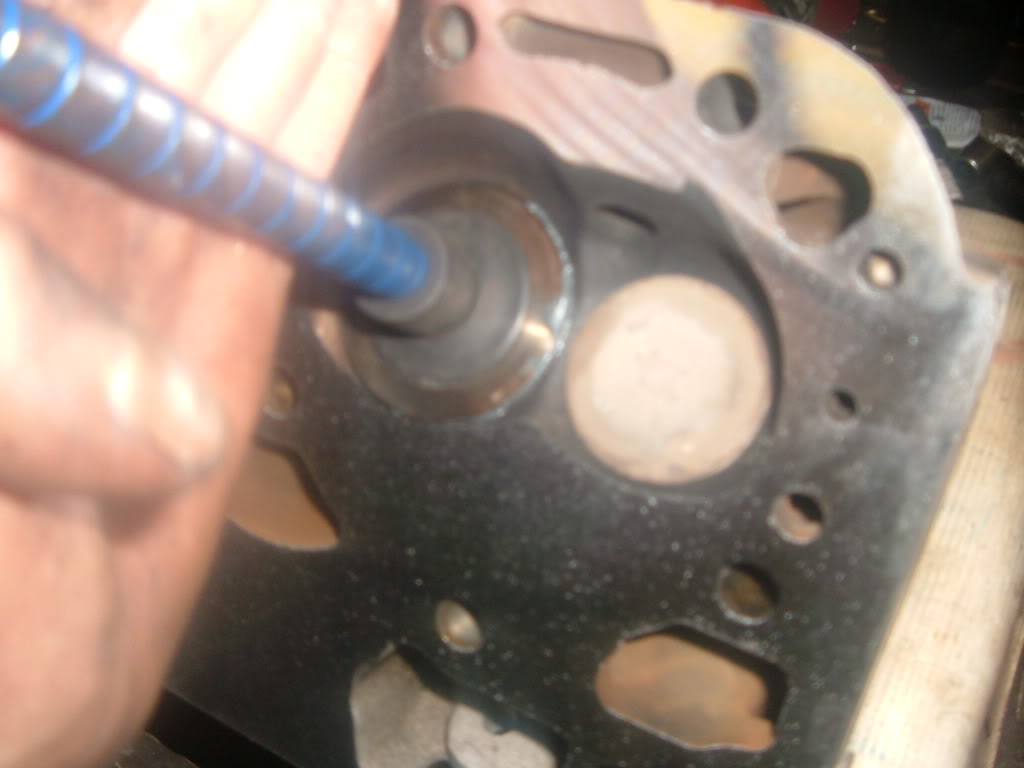

Once the valve has made contact with the seat, stick the lapping tool onto the valve and spin the tool back and forth with both hands. You will feel and hear the valve grinding compound “crunching”. At random intervals lift the valve up so more compound will work down on to the seat. Appox.10-15 seconds.

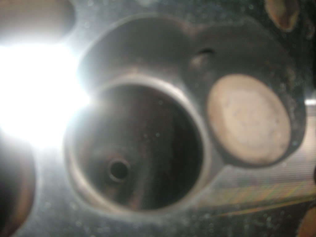

Remove the valve and wipe clean and inspect the valve face, It should have a gray, or whatever color your compound is, line all the way around the face. IF not the valve is bent and should be replaced.
