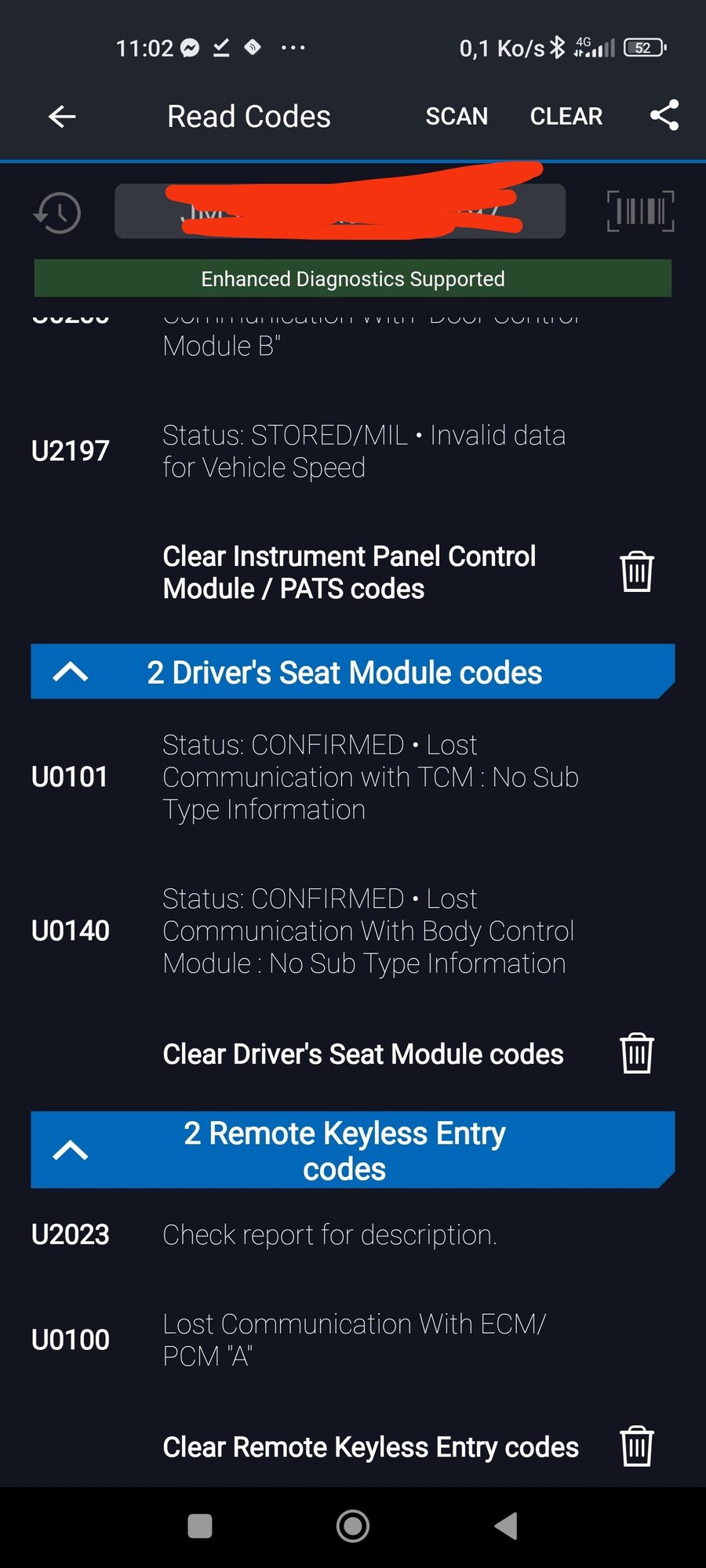

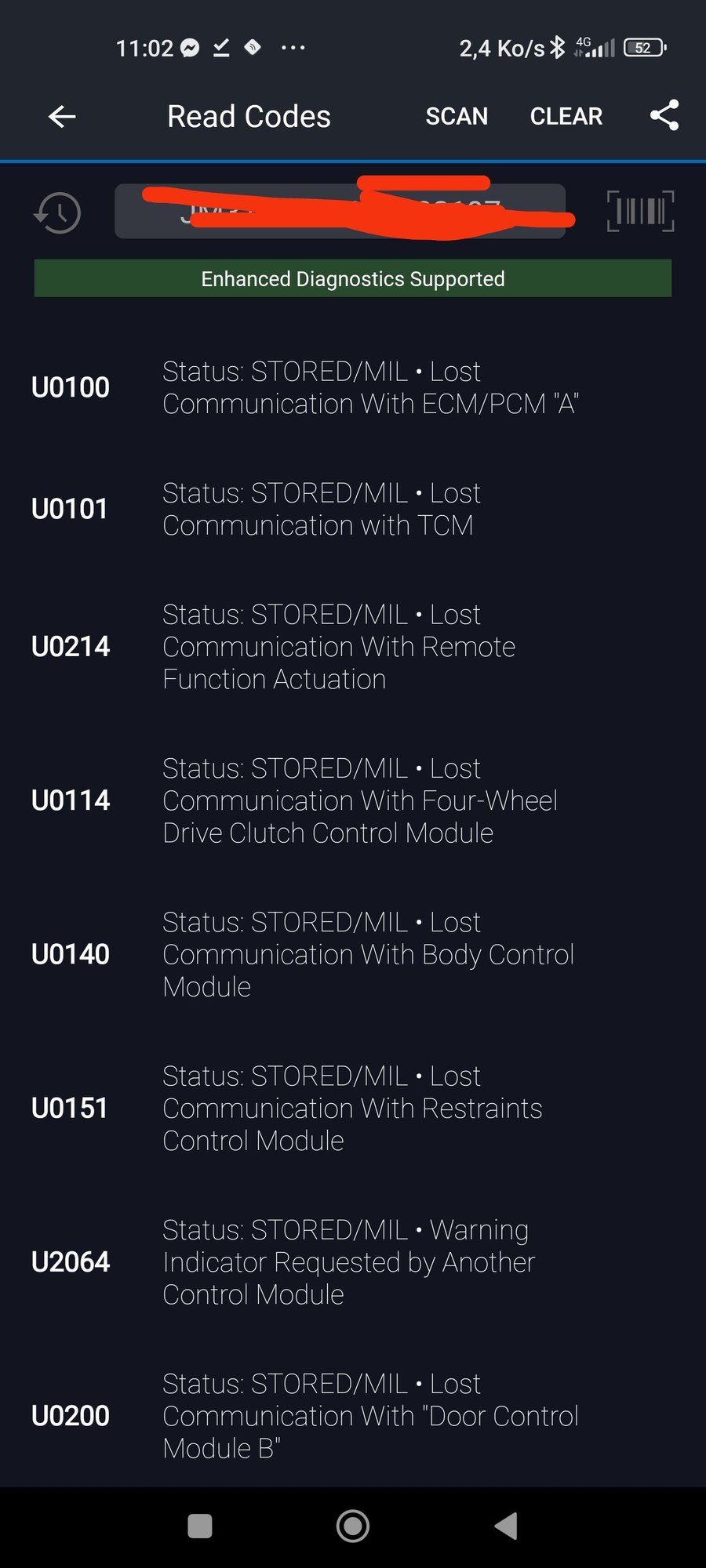

I recently purchased a 2010 cx-9 with 200,000kms on it. Its awesome! The car works great! But not when it rains. When it does rain, the ecm Looses contact with every single computer on the car, bcm, tcm, fan, cluster, seats etc. Symptoms are: hard shift, stuck in 3rd Gear (because if the tcm), cluster not working (vehicle speed data invalid), fans goes nuts, every lights IS on in the dashboard. I took apart the ecm but there isnt any water damage. Still sealed it good though. I looked at the most obvious connections/grounds and put Grease on them. I got two scrapyard computers that I will try later on once I program the keys to it. Is this a known issue please help me!

So first thing is to get a REAL Diagnostic scanner and NO BLUETOOITH.
Then go you your OBDII diagnostic connector plug in the diagnostic scanner
Then start over!
The first thing to do is note all the DTC then go to monitors and note which are not READY.
Then go to pending DTC which is different from active DTC and note them.
Then reset EVEYTHING also the Monitors. Don't worry the pending file remains until the problem is solved.
Once you do a completely cold start as soon as the engine check light appears quickly connect to the OBDII connector and get the active DTC.
The other very important thing to do is to check the battery health and the terminals on the battery as well the starter lead and especially the ground lead.
Checking the health of the battery means having it properly load tested. Please don't comment the age of the battery it is useless information!
If you insist and continue to use a blue tooth device ...well good luck with that and you will likely at some point, be towed to a service shop.
