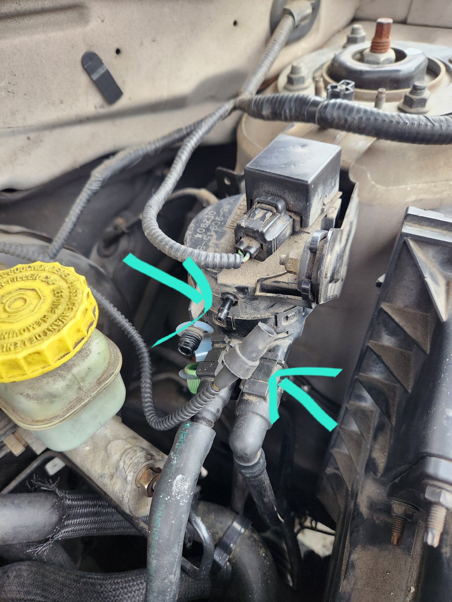

I was having the exact same problem but undid this hose and it's been running fine since. I plan to replace the whole thing when I can but for the moment, this is working

Mine stalled after fueling and randomly at idle with the brake and also had an annoying surge sound before hand and as I stated, removing this hose from the solenoid has been a temp fix. So...... 🤷🏼‍♀️

I have the same purge valve as that pictured in this thread. It was easy to remove the upper hose that comes from the charcoal canister, but I couldn't get either of the 2 lower hoses to release. I don't want to apply so much pressure (e.g., with pliers) that it results in breaking the plastic retainers. Can anyone provide advice on getting these 2 identical retainers to release?
