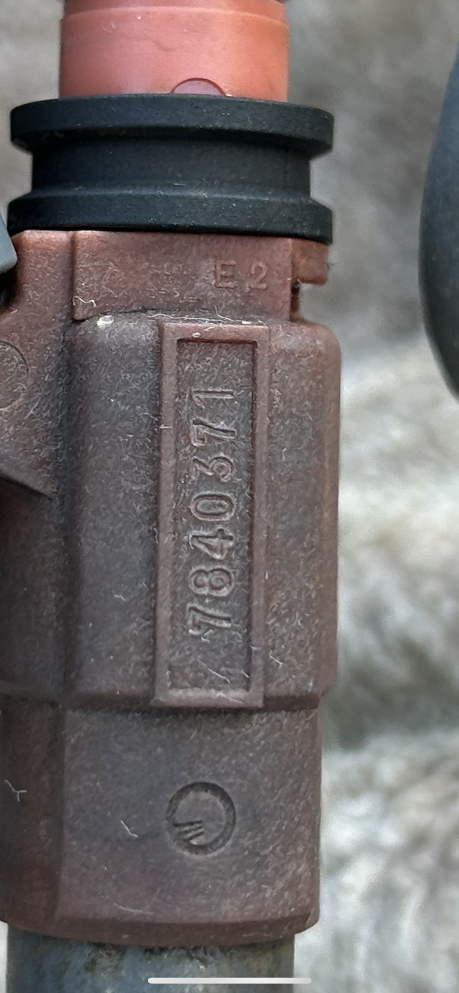

I appear to have a faulty injector
Part number 7840371
It doesn’t come up online at all
any updated part numbers or cross references please
much appreciated 😊

7840371 wont be the genuine Mazda part number.
Have you enquired with your local Mazda Dealer parts department?
Goss part # PIN618 shows up in REPCO's system for your truck.
Also Sparesbox https://www.sparesbox.com.au/part/go...njector-pin618

Thank you -I’ll check that pn out
much appreciated 😊
