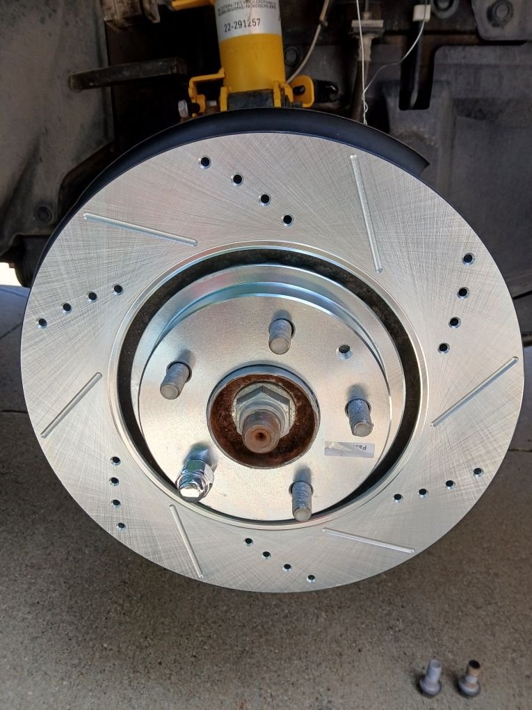

Finally got around to improving factory brakes. Not enough initial grip. Too soft a pedal. I took care of the grip but not yet the pedal fill. Although... it did improve with the pad and rotor change.
Went with PowerStop rotor & pad kit. Was pricing EBC bits, which I've loved in past, when I found a helluva deal on the PowerStop kit. Zinc plating will help in the Midwest. Drilling adds a bit of looks. The Evolution Z23 pads are not my preferred choice. Don't get me wrong, things are HUGELY improved over factory. If I had my choice I would like to have Hawk HPS. Had them on my 3 previous cars and been thrilled. But, alas, they do not make them for the CX-5. I'll give these a ago and see if I remain happy.
Have not yet installed the braided lines. Kinda missing the immediate feel and response of them. I'll do them soon.

Looks good.
you may want to use some navel jelly in the hub nut area to remove the rust then shot some rattle can paint to keep the rust under control
