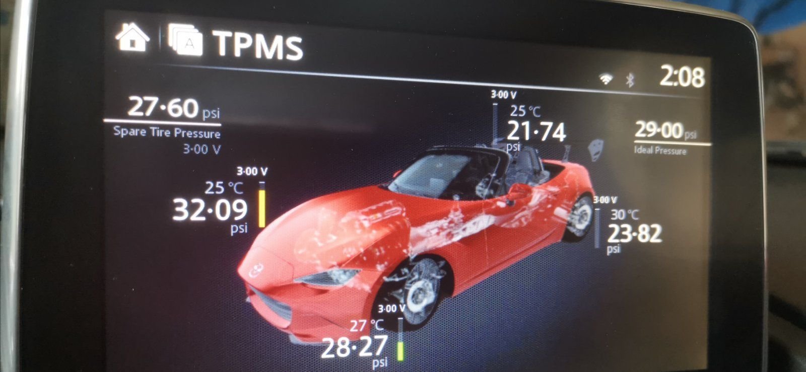

Recently upgrade car with a DIY TPMS system. These are using VC601 Bluetooth tire pressure sensors which can spew out via bluetooth advertisement tire pressure. temperature, and even sensor battery and then displayed on the screen with the correponding captured values.

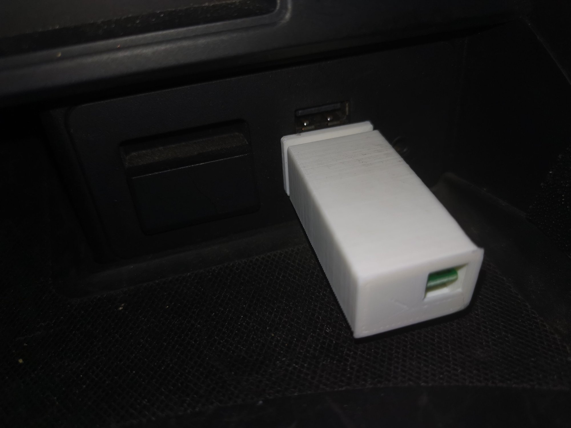

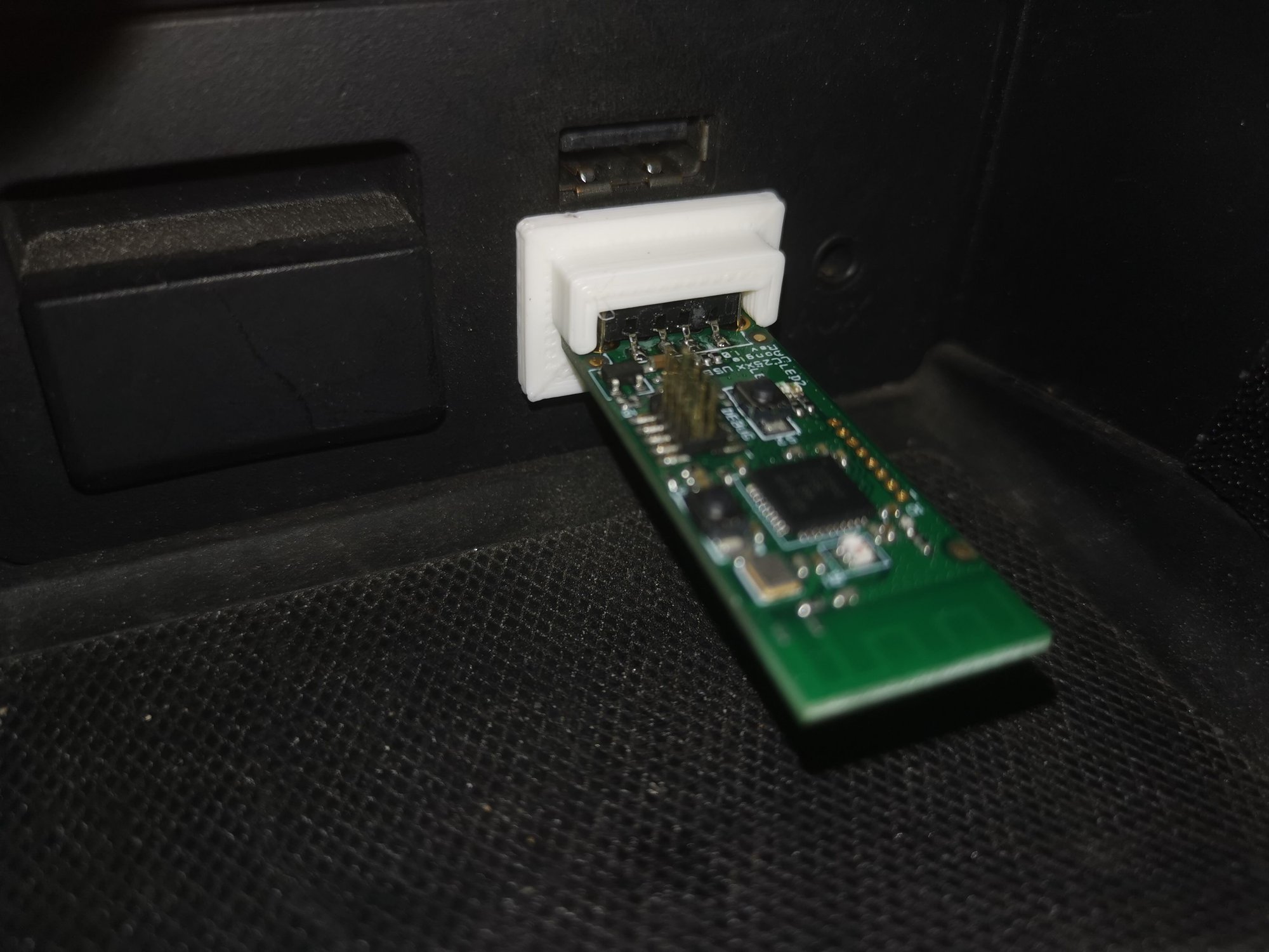

To receive the data, you need to capture the transmission using a bluetooth receiver plugged to the USB port.
