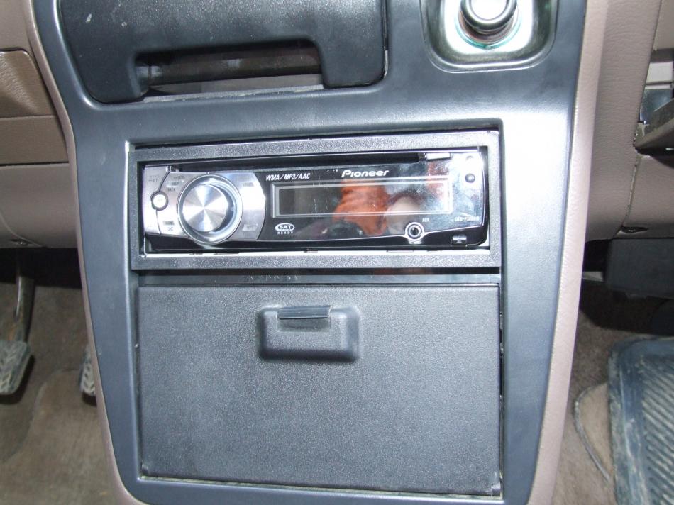

Just installed a Pioneer DEH-P3000IB into my 1991 Mazda 626 with the supposedly ' Vehicle Specific' mounting kit. I will live with the results however the kit is not specific to my 1991 - 626 as I now have a fairly large gap at the bottom where a storage bin was located. The factory head unit was a 1-1/2 DIN and the aftermarket kit (Best Kit's) is a 2 DIN which did not allow for the re-install of the original storage bin. I just wonder is there a way to modify the new mounting kit that would allow me to install the old storage bin.

I think if I remove the bottom cross-bar and trim the lower
side plates of the new H/U retainer 1/4" to 3/8" then I'll be able to put
the old storage box clips back, which mount to the back side of the original trim stack. I may even try tin bashing a new bracket as the head unit seems a little loose. I've attached a few pics of the new HU install, to give you a better idea what I'm dealing with.
I looked at the instructions for the trim kit and went with the setup for a
Mazda 323 as the OEM Head Unit was the same size as well the layout was
similar, bin at the bottom. Also got a link from the Pioneer website for
Metraonline.com the instructions were similar to what I mentioned before of
removing the bottom cross-bar and trim the lower side plates of the
retainer. Better now as the storage bin is back in place, but I can't place
the trim plate around the deck as it pushes the factory stack out to far and
the one that comes with the kit fits in to loose. (perhaps a little silly
putty, lol) See the pic's attached of the end results. Maybe I'll see if I
can cut up a piece from the kit to fill the small space under the deck trim
somehow and attach it with putty also
