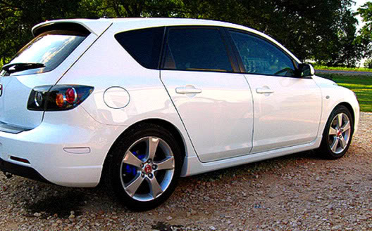

Default RE: Rear Bumper Removal
Just climb under there, find the clip and release it. They release from one side and just getpulled out from the other.
That's how I did my side reflectors, but I've had the rears out too and w/a hitch installed. No screws and no bumper removal should be necessary.
