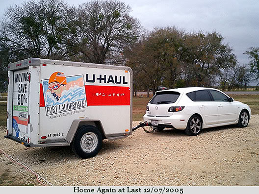

This is how....
Because your car and mine are very, VERY similar. If anything mine has a bit more power and a little less weight. I drug this trailer for 1640 miles and would not recommend it to anyone. I will never do that in that way again to my car. It was miserable.
