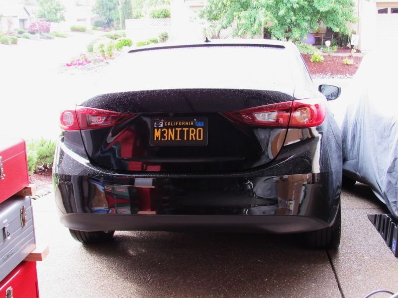

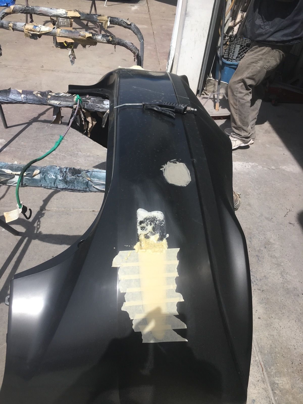

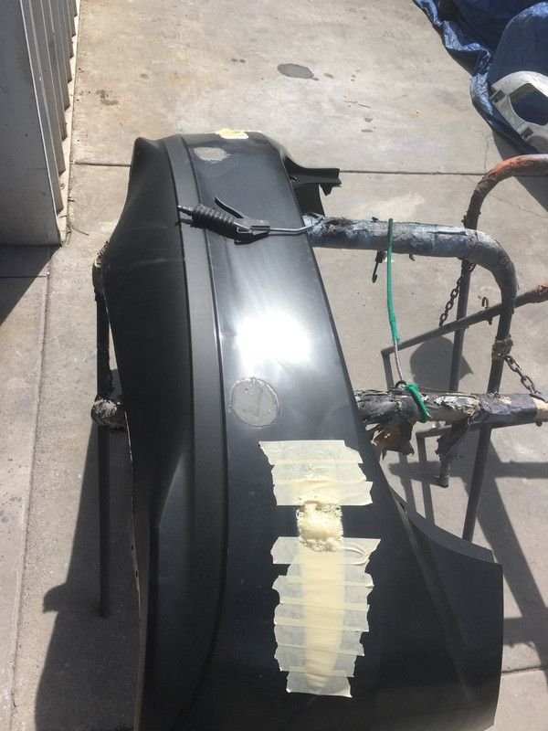

On my 2018 Mazda 3 used the Tow hook covers as the filler, plastic welded them in place to eliminated both the holes and the "can-open" reflectors.
