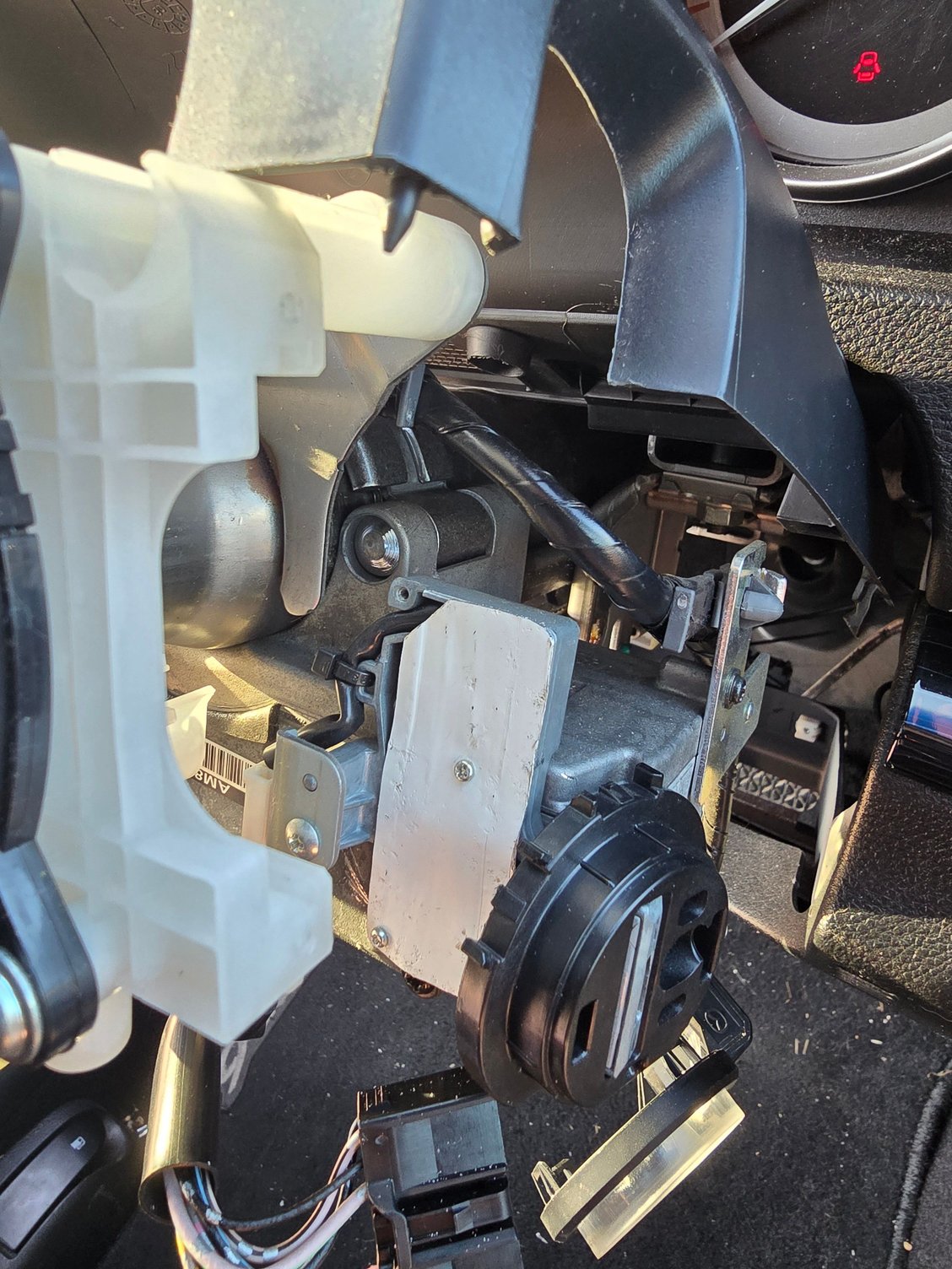

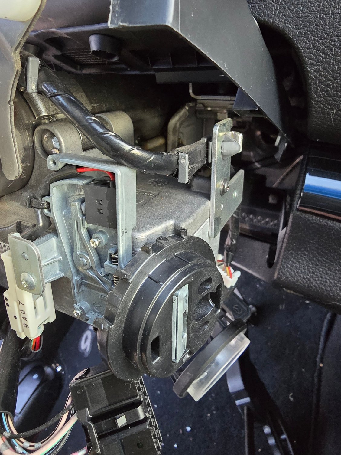

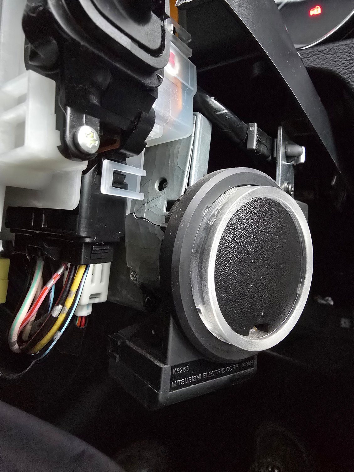

If you have a push button start, when you insert your emergency key into the slot on the column, it moves a little lever that activates a switch telling the vehicle you've inserted a key. Well, they used really cheap materials when making the cover over that lever and it literally crumbled inside my steering column causing the lever to move around. It started with my alarm randomly going off and the dome light randomly turning on. It progressed to the point that my fob would no longer set the alarm or lock the doors at all. I fashioned a new cover out of some scrap tin laying around the garage and haven't had any issues since.
