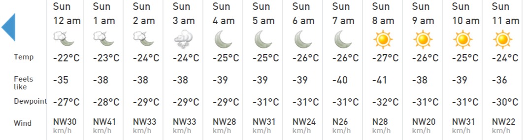

It was -26 last night with a wind chill of -40 or so.
It started no problem at lunch today! Because of good battery wrapped in insulation as well as high performance ign coils, synthetic oil. Battery is also a little bit bigger than stock, but it fits, read earlier posts to see.

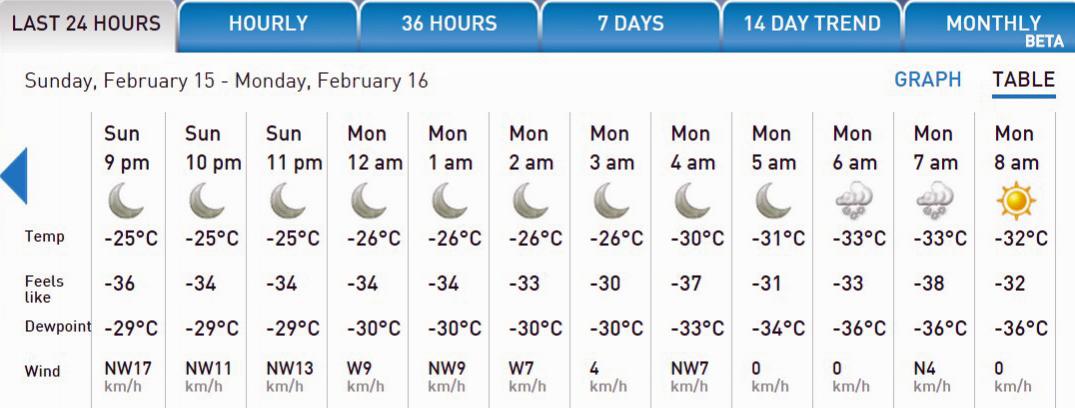

Was -27 degrees Celcius thru the night feeling like -40.
Car started fine. Same temps tonight! Started again Mon Morning 10:00 am.
Combination of great battery, winter front, insulated battery, solar panel, synthetic oil and hi power ign coils all help!
See attached pic of temps.
