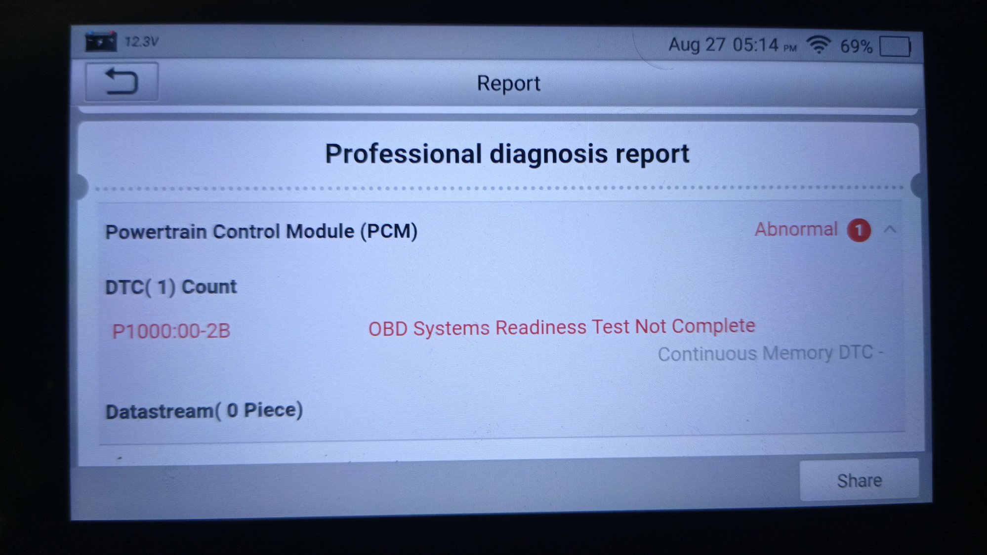

Error codes: I get only this one:
P1000:00-2B OBD Systems Readiness Test Not Complete
So, I suspect it's the immobilizer system. It's there a separated battery for the security system or something like that? How would I proceed from here?
So, I suspect it's the immobilizer system. It's there a separated battery for the security system? How should I proceed from here?
