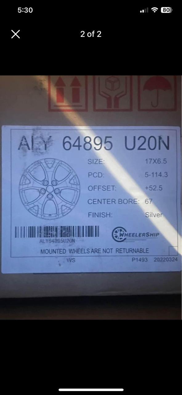

I have 2 bad rims on my 2010 Mazda 5, was wondering if these Mazda 3 rims pictured below will fit?
thanks for your help

All Mazda 5's have the 5 x 114.3 bolt pattern so you're good on that front. The offset is 50.5 - 54.5 so those with the 52.5 offset should be fine. From what I can tell the center bore is the same as well. I know multiple people have put Mazda 3 wheels on their Mazda 5 so I think it's probably a safe choice
