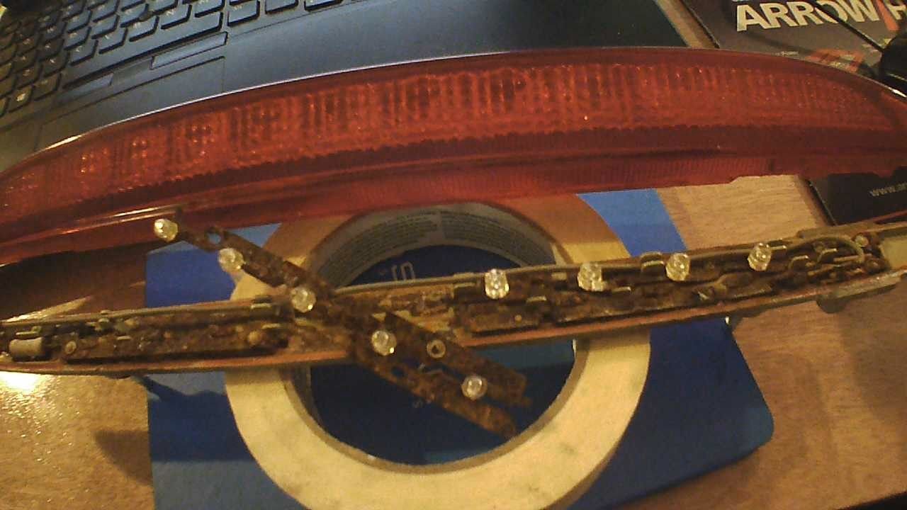

The 3rd center is another story. It's rusted out, new one is $100 on the auction bay.

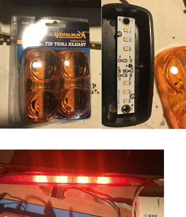

In case this helps anyone.
I picked up a set of trailer lights at Harbor Freight for $6.50 and RTV the led elements inside the original housing and spiced the wires. It required a bit of fiddling around but managed.
I got the light housing apart with a knife and prying without breaking everything. Afterwards I came across a few YouTube where people use a heat gun to soften the glue.
Check engine cleared itself and now all the stop light work. Weekend win.
