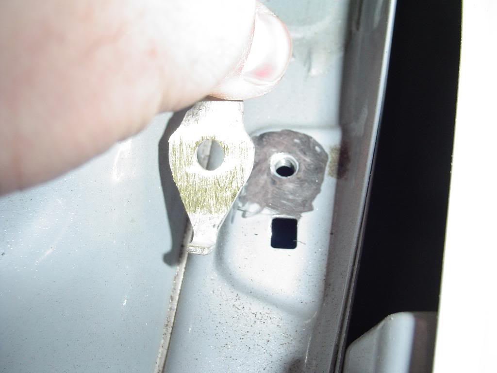

I can tell you how to fix it. Mazda could care less how fast you want to go. They just want to sale the car. Point being the delaership I went to said this problem is normal! So I had to figure out the fix myself. I didnt figure it out till a few days ago thanks to a post in another forum. The biggest fix I found on my 03 Mazda 3 2.3L Auto is to fix the battery ground wire. It is about 2 feet long and goes from teh battery to the left tire well. You will see that the black wire is screwed down to the frame. Unsrew it and notice that there is paint under the screw. There is no way you will get good electricity flow throw paint. So scrape the paint off so you will have bare metal touching metal. Screw the wire back and find that your Mazda 3 now has no stall or hesitation. Its by far the best and biggest fix I made to my car. Got rid of all the stalling and hestitation the delaership said was "normal"
Pic from another post from this forum http://www.mazda3forums.com/index.php?topic=33092.0
