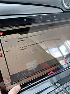

Problem with my Mazda 3 2.0 150hp.Check light on dashboard,Delphi diagnostic test showed errors as in the attachment to the image.I changed two lambda sensors and after 50 km the same error occurs again and you feel a bad smell of a rotten egg from the catalyst area.I checked the fuses 32 and 33, but in place 32 there is no fuse and it can not be turned on because there is no fuse socket. It says on all service books that no.32 is for oxigen gen sensor 1, is it possible for my model no.33 the fuse is for both oxigen sensors? Any advice please.
