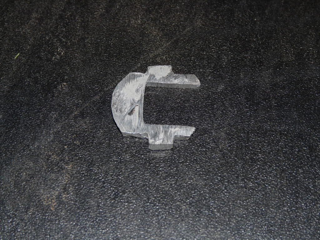

http://www.ddmtuning.com/, it has everything you need including the adapters for the lights to fit correctly. The ones from VVME did not have them so I had to make my own.
Old Aug 21, 2010 | 03:43 AM
Agreed. The adapter is necessary and makes the install that much easier.

i had no problems with mine, install went like a breeze and the lights sat perfectly in the housing, what does that adapter do?
