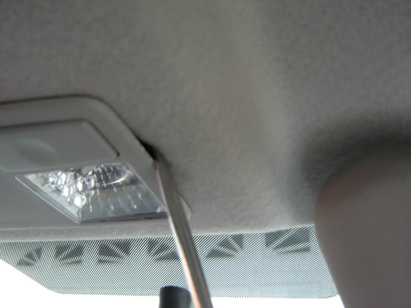

I did the same thing. Get a flat head screwdriver and pop it out. here a pics.
This is the passanger side. You only need to pop out one side and then the other will come out too. Stick the flat head in the middle of the side and have it at an almost 90 degree angle. There is a metal clip in there that is holding it in and you just need to bend it.

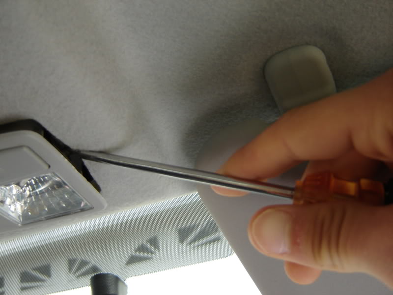

Once you feel the flathead on the metal clip, pull the screwdriver in the counter clockwise direction and the clip should unlatch

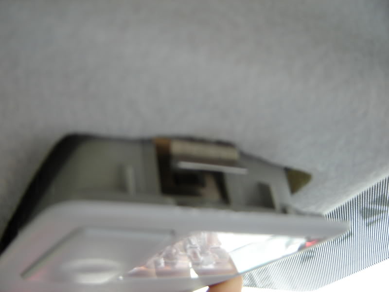

This is the metal clip you are trying to get. once it is out the outher side will come out too. Then it is the matter of installting the bulbs which is easy.
