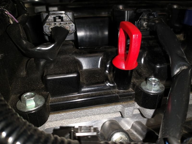

I painted my dipstick RED as a visual aide when I respond on forums because this question about how to check oil level is frequently asked and misunderstood on MAZDA forums how to correctly do the simple procedure

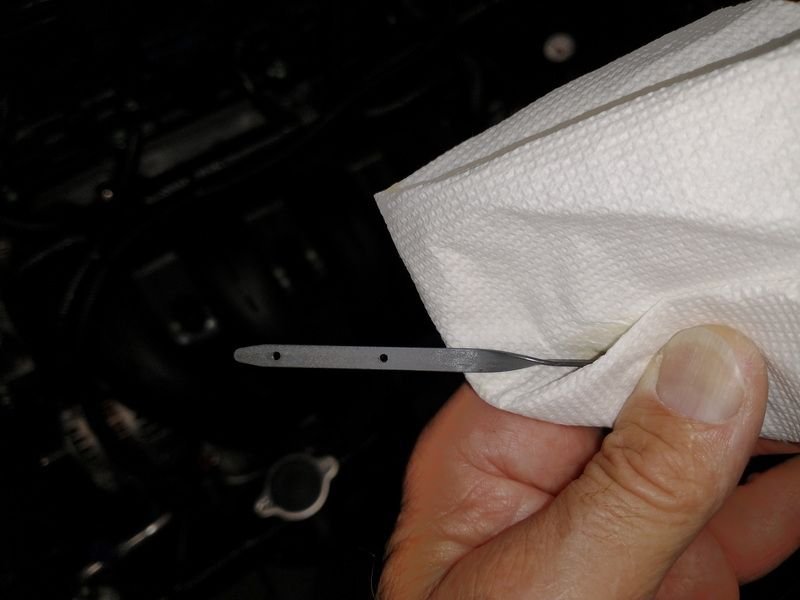

Use a paper towel or clean rag to completely wipe cleaned and dry of any oil residue before reinstalling dipstick to check the oil level
Skyactiv engine gasoline. The 2 holes are the indicators of the CORRECT oil level. You can safely run the oil level anywhere in between these 2 holes or if your oil dipstick has lines.
This is the incorrect position for checking the oil level.

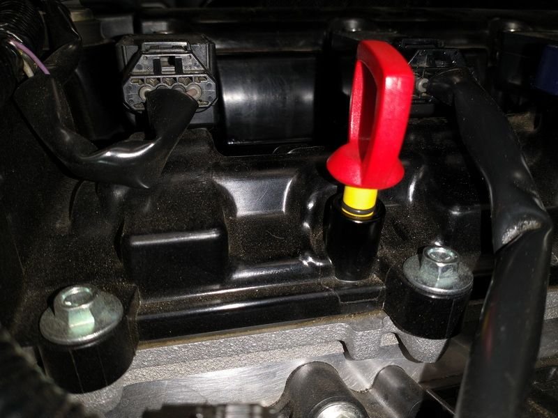

Make sure that the oil ring is in good condition. The dipstick should need a good push when installing indicating a proper seal.
Make sure the dip stick is complete installed for checking oil on dipstick

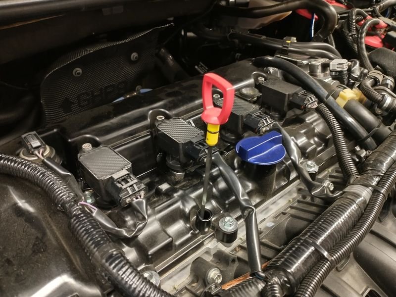

Push the dipstick completely into the valve cover and quickly remove it.

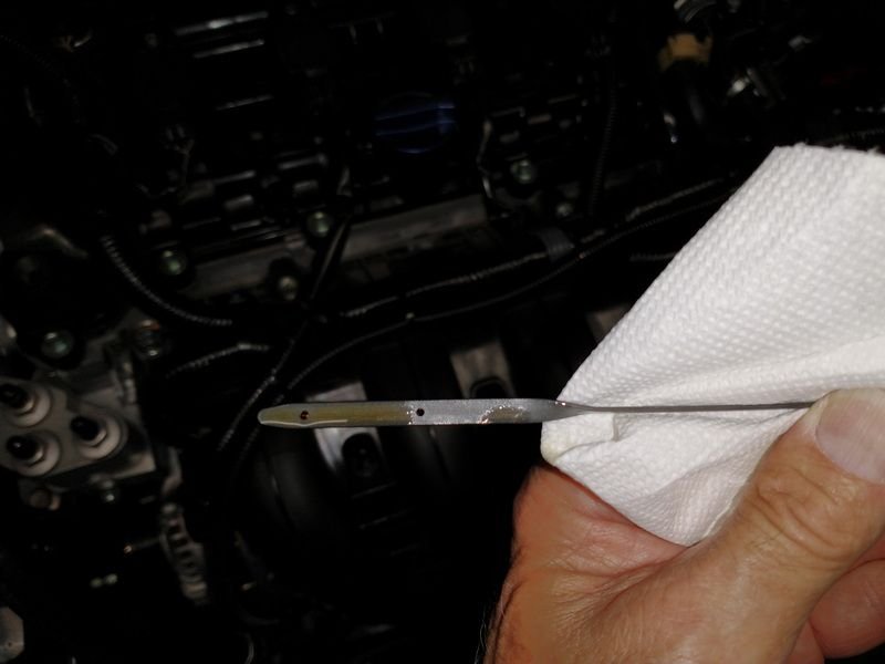

This is full and within normal oil operating capacity range
This is my oil level at full capacity with the engine at rest for about an hour and still registering approx.. 100F at the oil pan. Measure with a handheld digital thermometer.
