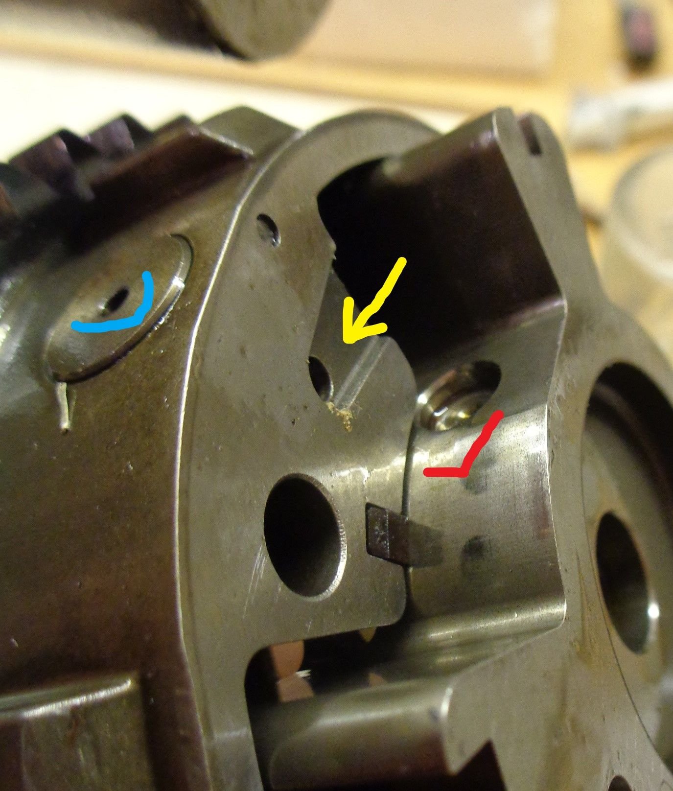

VVT after 100k miles shoud work, but ... worn, sticky locking pin etc. (see pic), works randomly as no-no-go at aprox. 3k RPM.
