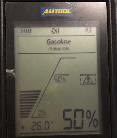

Also:
5W40 Full Synth GTL 4,113kms stop start city short distance trips on the Fluid Transmittance = 50%

Also:
5W30 ECT3 Full Synth GTL 4,926kms stop start city short distance trips on the Fluid, Transmittance = 50%
