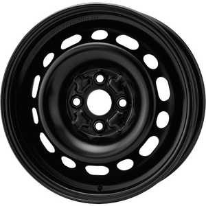

Alcar 5710 5Jx14 ET39 4/100 54.1 steel rim (from Toyota Yaris 2006-2011) (175/65R14 tyre size)

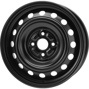

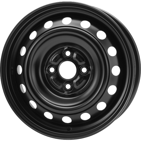

Alcar 7890 5.5Jx15 ET45 4/100 54.1 steel rim (from Toyota Yaris 2006-2011) (185/55R15 tyre size)

175/65R14 is a cheaper and more comfortable tyre size than 185/55R15, and because it has higher sidewalls is more resistant to pothole damage.
Vredestein Quatrac 5 175/65R14 82T (Euro label D C 69dB)​​​​​https://www.camskill.co.uk/m137b0s79..._Noise%3A_69dB

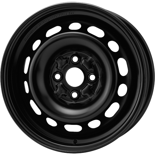

You can get a Mazda 2 steel rim for the 185/55R15 tyre size, but it has a 6J rim width, which makes for a slightly harder ride compared to the 0.5" narrower 5.5J rim from the Toyota Yaris. It's also a less attractive design than the Toyota Yaris rim.

Alcar 7190 6Jx15 ET45 4/100 54.1 steel rim (from Mazda 2 2007-2014) (185/55R15 tyre size)
