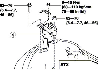

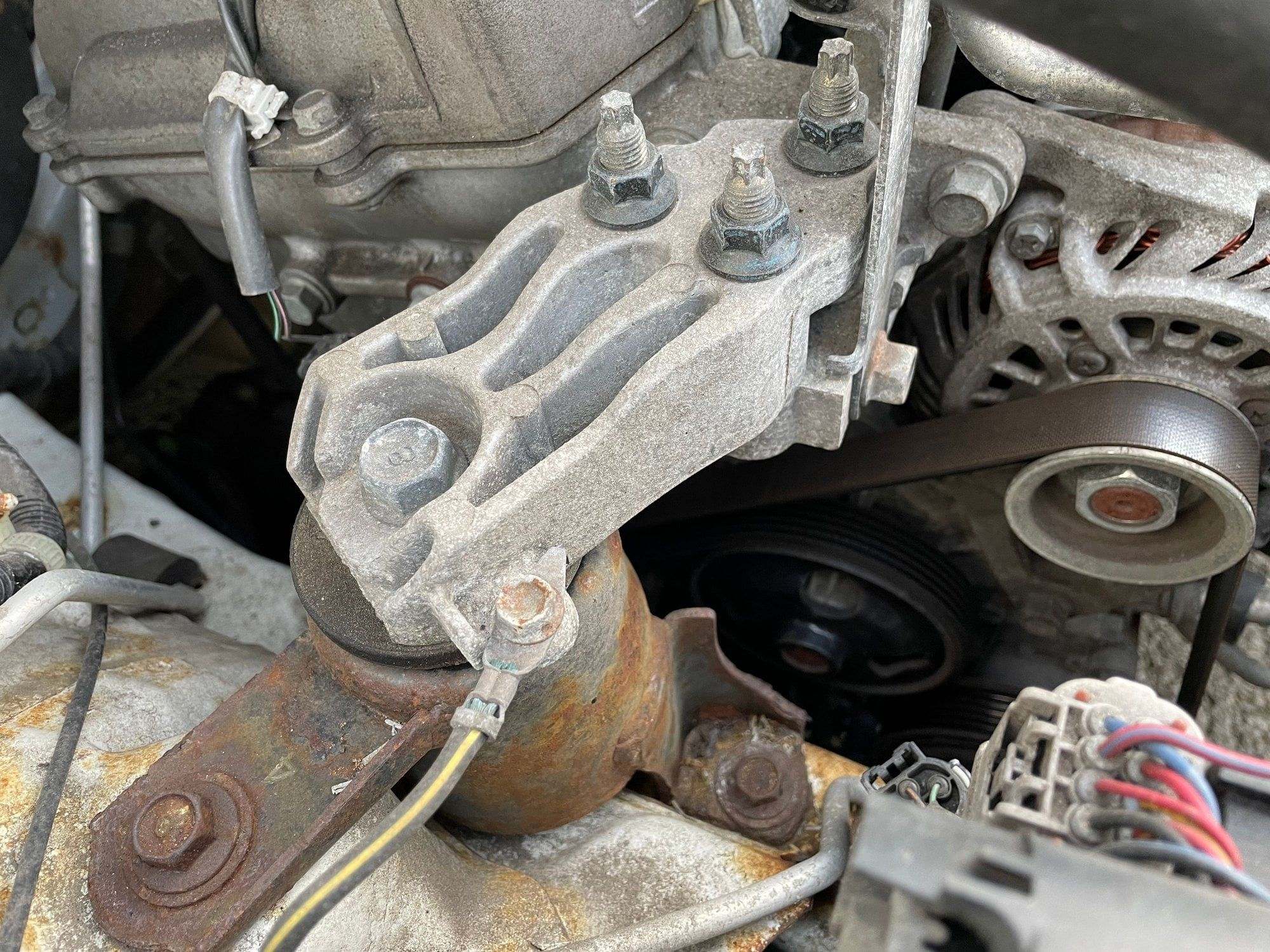

Hello, Im replacing the engine mount on my Mazda2, which, as you can see, has its own bracket.
But in the workshop manual it says not to separate them but to replace them (mount & bracket) as a whole
And it doesn't even provide with the torque spec for the bolt
But the one that i got from my local parts store didnt have that
Will this create any problems if I reuse the old bracket?
