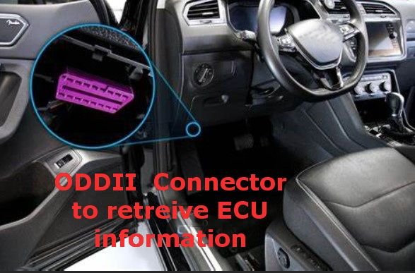

You must find a shop that can "LOAD TEST" the battery not just charge it.
If you look under the driver side dash you will see a connector like the one pictured.
To get the informatio9n your Mazda computer you need a "SCAN TOOL" to plug into that connector.
Then follow my suggestion what to look for.
