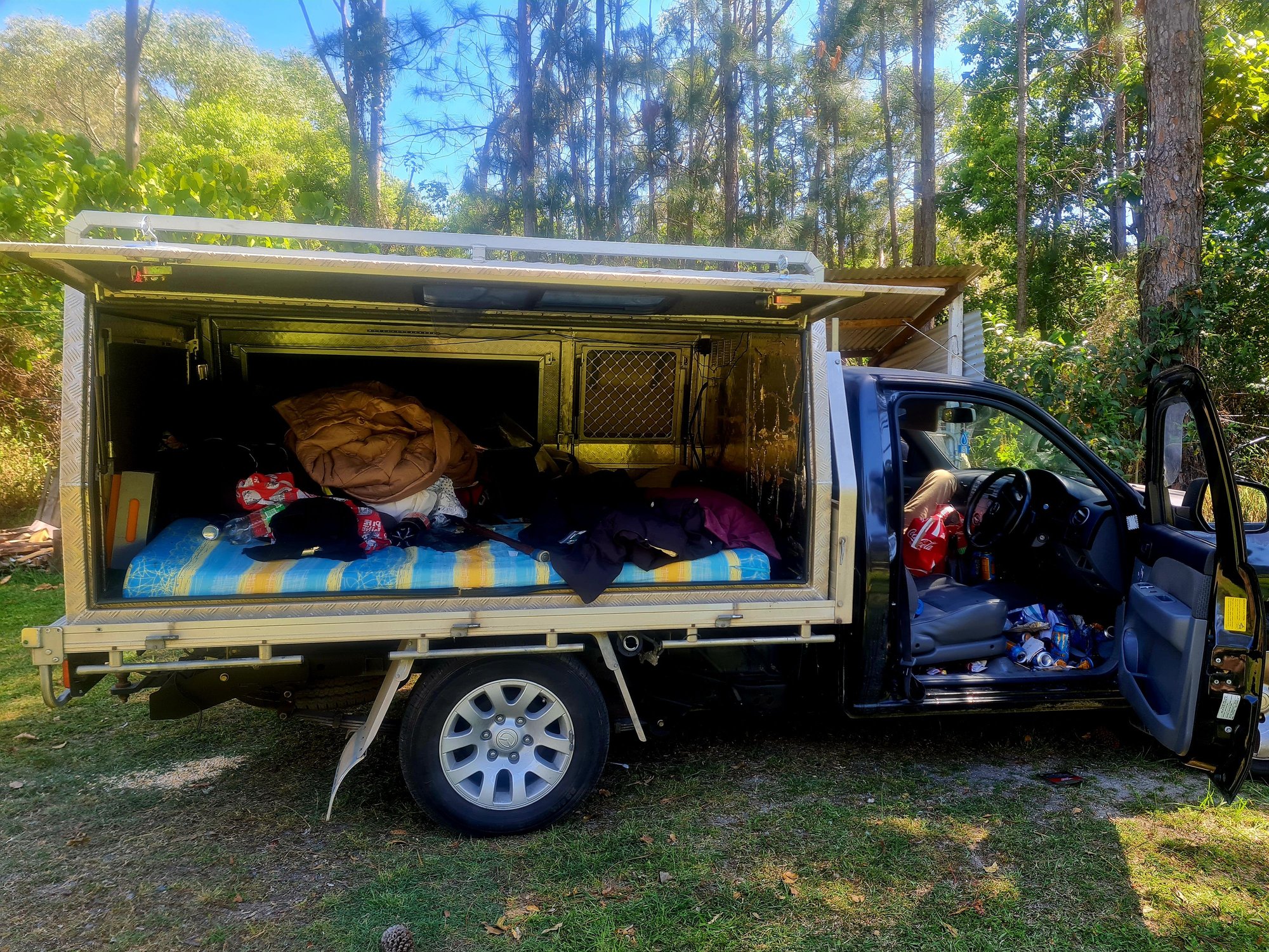

yes it's very strange. May not be temp but maybe usage. It's a shame as I have a giant checkerplate canopy on the back with twin lithium and a 12 v tv. It's cool t o camp in and I would love to fix it

air flow? Something is definitely making a definitive change and stopping my glow plug light coming on which is the only waonly will start.
