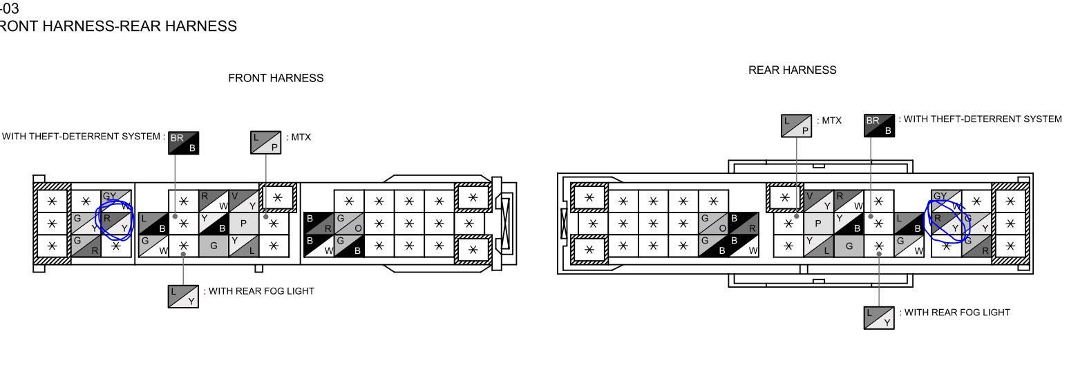

I did come across this when researching places to tap the reverse wire:
It's c-03 for the bcm. I haven't found the rest of this diagram though, but I suspect it'll have what you're looking for. BCM is located under the dash on the left side I believe. c-03 is big and blue, with a white plug. Unclear which pin is for the dome, but I guess you could drop the domelight and test, or just probe them all door open vs closed.
