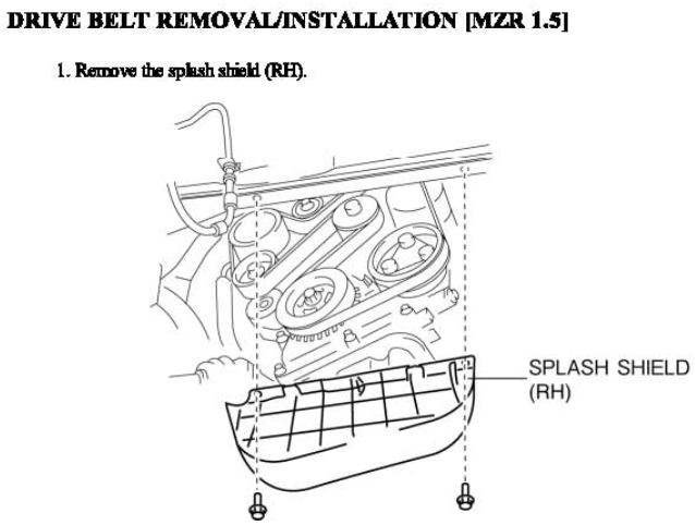

[3] Undo 2 of M10’s & remove the Accessories Belt Splash Guard
Fig [4] Accessories Belt & Auto Tensioner with the Accessories Belt Splash Guard removed

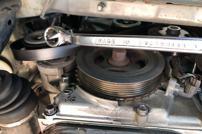

[4] Combine the 14mm OE Ring & the 12mm Offset Ring for additional Leverage, Release the Accessories Belt “Auto Tensioner” & remove the Accessories Belt
Fig[5] Release Auto Tensioner & Remove the Accessories Belt
Fig[6] 14mm OE Plus 12mm Offset Ring Spanner for Additional Leverage.
Noted access to the 14mm Auto Tensioner Nut is limited & a rigid brake line that you could move is in the way making use of a socket & standard breaker bar difficult. You could also place a tube over the 14mm OE but the 12mm Offset Ring Spanner works well.

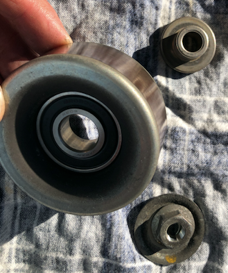

[6] Remove the Idler Pulley & Rear Bush
Fig[8] Idler Pulley & Rear Bush Removed

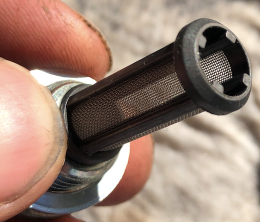

Fig[10] VVTi Oil Screen Removed Before Cleaning, it looks ok at 180,000kms, as the vehicle has run Full Synth

[9] Clean the VVTi Oil Screen using Throttle Body Cleaner
Fig[12] VVTi Oil Screen Cleaned
[10] If the VVTi Oil Screen is undamaged you can reuse it. If not Replace it. (Suspect that at >250,000km the polymer VVTi Oil Screen Cage will be brittle & crack, the Corolla 1ZZFE's typically are brittle at >250,000km) for my MAZDA2 it was ok at 180,000kms for cleaning & reuse
[11] If the Aluminium crush washer is undamaged you can reuse it. If not Replace it.
[12] Using the 8mm Std Allen Key Reinstall the VVTi Oil Cap with the VVTi Oil Screen fitted, then retorque using a Torque Wrench fitted with 8mm Allen Key = 32Nm

Fig[13] Accessories Belt Removal Pg619 from 2013 SUPPLEMENTARY MANUAL 1509Pgs = Not the same as Oz Cars

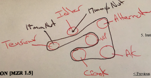

Fig[14] WRT Accessories Belt Routing = Its Better to Draw your own Complete Accessories Belt Routing Diagram for your car before you start.
