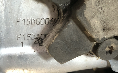

Fig00 Transmission F15DG006A - MAZDA 2 FN4A-EL 4Sp Auto with Lockup Torque Converter

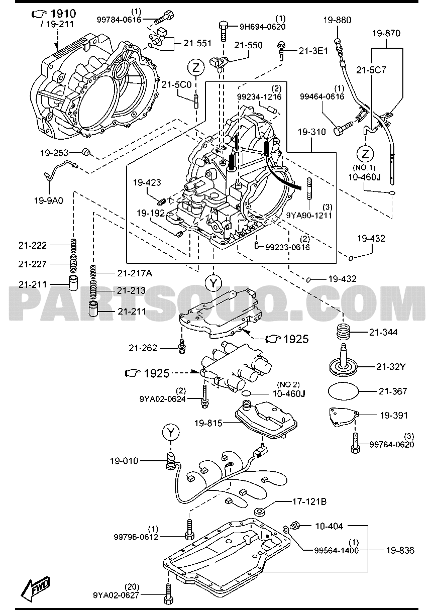

Fig PD1 Automatic Case & Control System 2d44cf1

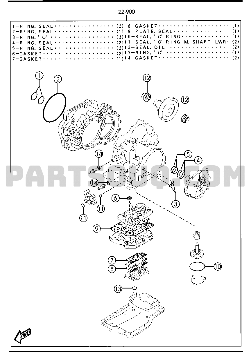

Fig PD1 FN4A-EL Automatic Seal Kit 2d29731

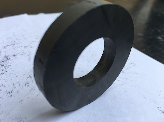

Cleaned the Pan & magnet
Note the clutch pack debrie etc on the paper & magnet....even after wash cleaning...so clean it again
Fig07a Hard to Clean the Magnet
