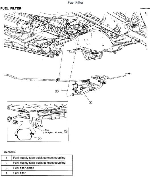

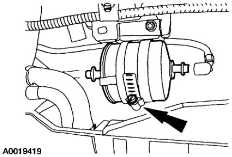

2 Attachment(s)
I pulled the All Data info and there's no mention about the O-ring in the install procedure - only for the recall as you mentioned.
Prolly the new procedure drops that O-ring all together?
Here are the pics from All Data
Attachment 409
Attachment 410
