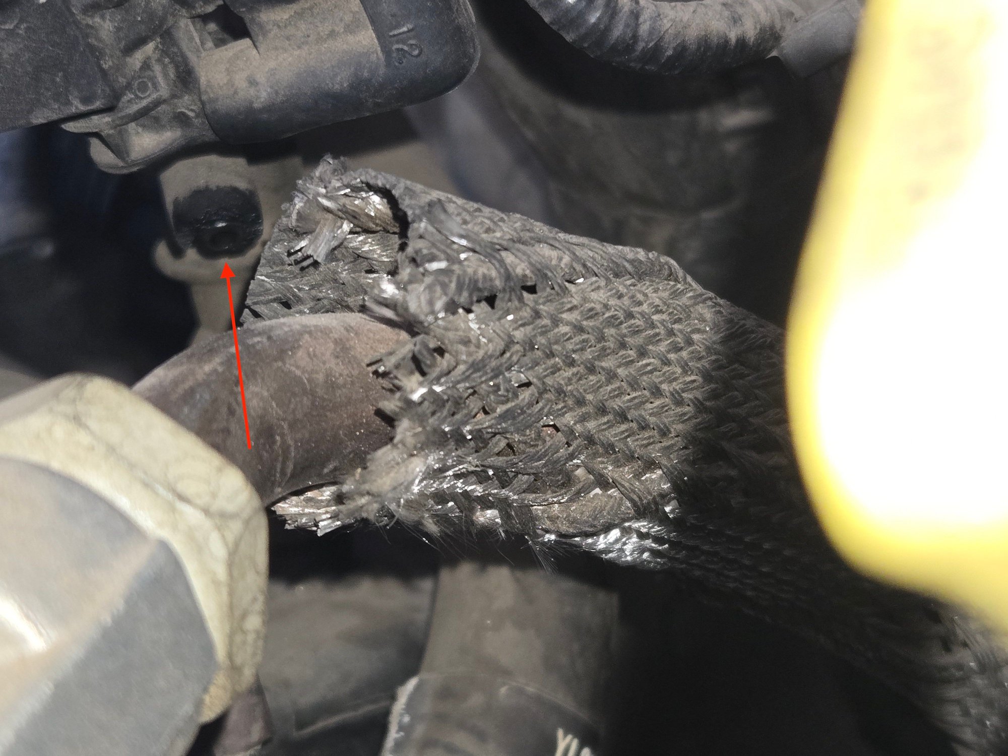

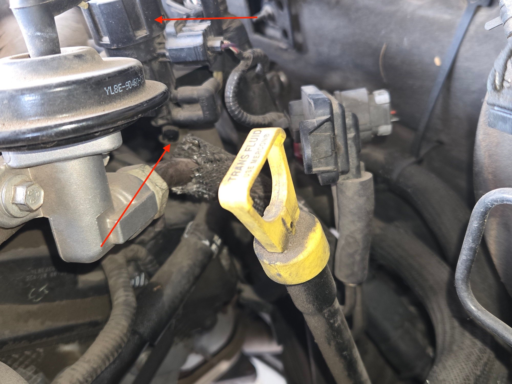

I have a vacuum leak coming from under the EGR vacuum solenoid on my 2003 mazda tribute 3.0L auto (there is a line that comes from the EGR vacuum solenoid that tees into the green vapor purge valve solenoid line). It looks like the vacuum hose crumbled and fell off part of the t-fitting after the two meet. Upon starting the vehicle, I can feel suction where the vacuum hose crumbled and fell off. In these pictures, I outline the vacuum line with green stripe leading from the EVAP purge valve solenoid, the EGR vacuum solenoid, and the open part of the t-fitting where the hose crumbled off (after both the EGR vacuum solenoid vacuum line and the EVAP purge valve solenoid tee into the fitting). What is the destination of this vacuum line so that I may fix this leak? Thank you

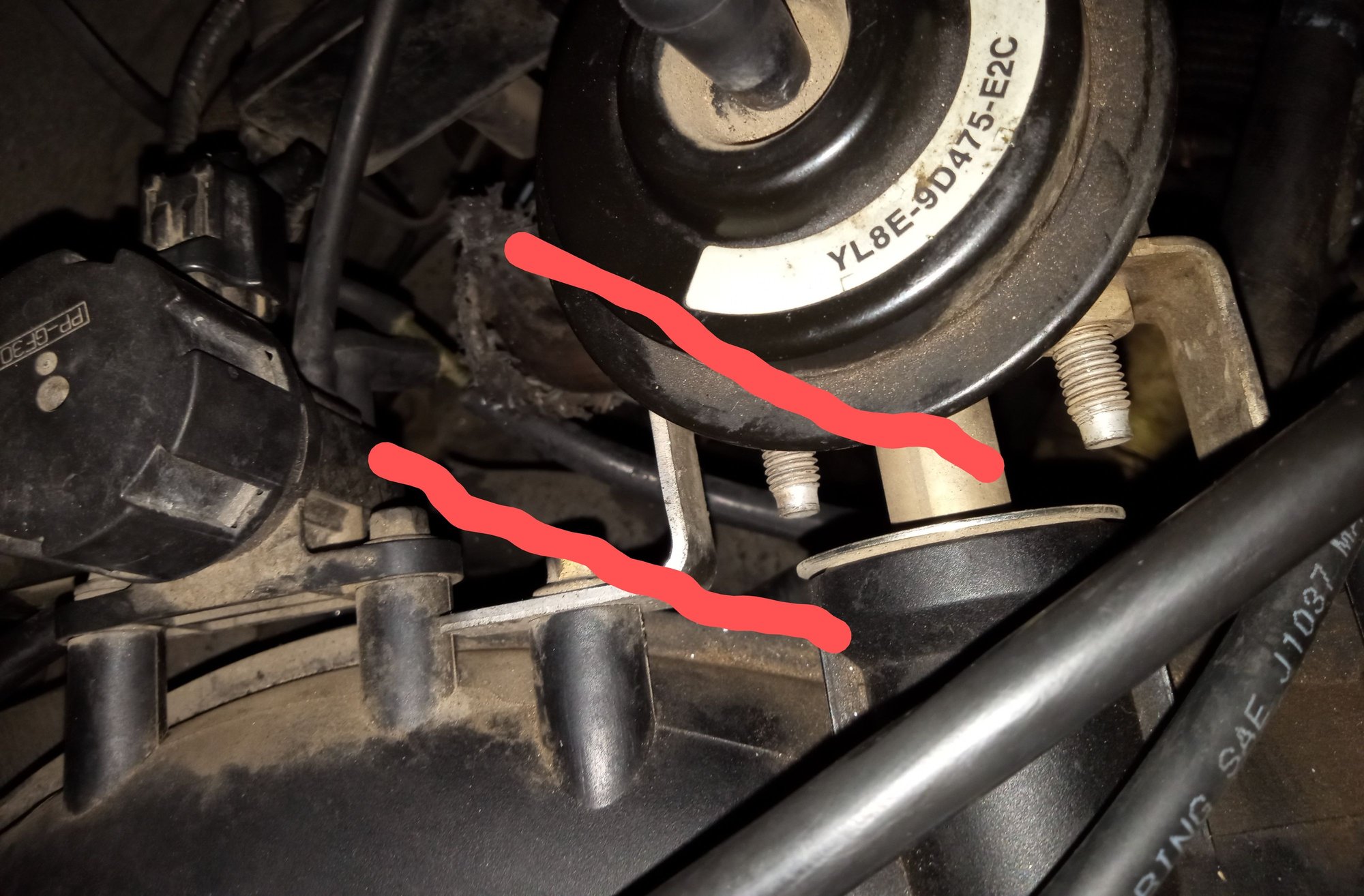

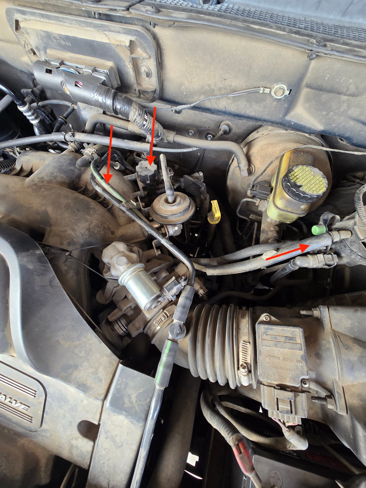

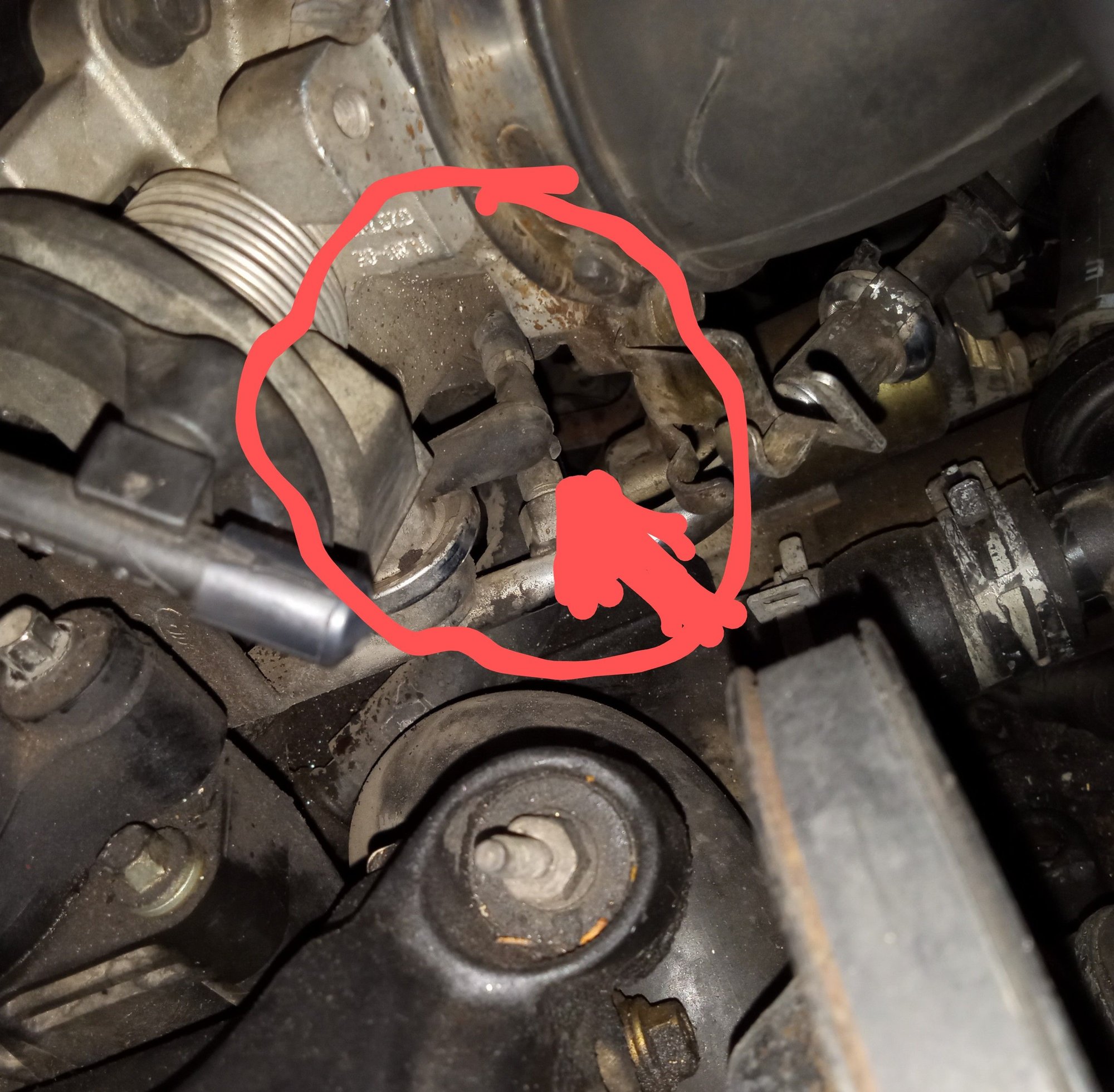

It's between the two lines.
Where it attaches
Where it attaches

My last post was the pictures. It wouldn't let me write anything though. The vacuum line runs under the throttle body. I just so happened to be working on my vacuum lines today and logged in here for some help on my project. I hope the pictures help.

Beautiful. Thanks for your help!
