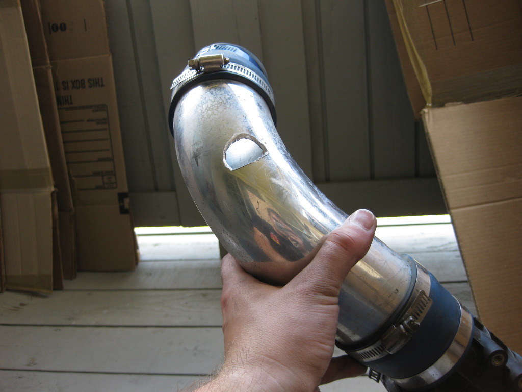

1 Attachment(s)
i'm pretty sure i found the problem. Attachment 4810
it's on the back side of the CAI near where it meets up with the throttle body. I could never have seen it if i didn't remove it. It looks like it was cut out with a tool by a previous owner (don't ask me why). I closed it off with several tightly-wound layers of tape and I think it's fixed now. I drove it around for about 5 miles and my long term fuel trim went from about 10% to around 0%, and the idle stabilized again. I want to drive it around a bit more to make sure, but i can't imagine it wouldn't fix it. p.s. i have no idea why the revs would not have increased when i sprayed around it with brake cleaner and instant start. i was sure because of that that I didn't have any leaks in the piping. oh well. |
Glad you found it. VERY BRUTAL!
