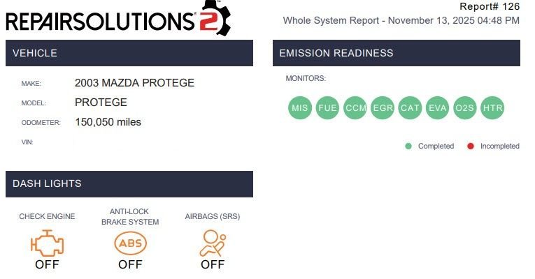

Saudade Nov 13, 2025 10:54 AM
So to close this out, ran another full scan. No Codes, all Readiness Monitors complete. Clean and Green!
https://cimg6.ibsrv.net/gimg/www.maz...6b2e743f94.jpg
@Callisto Thanks for the help and insight.
