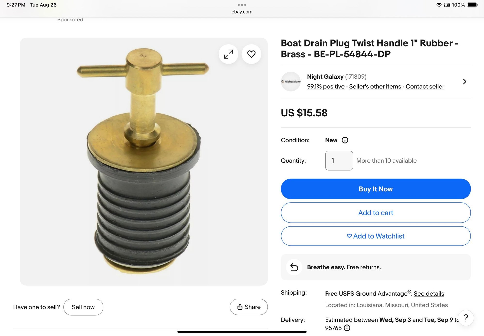

But the configuration on many Mazda reservoirs I think would make flushing an interesting act in futility don’t you think. Maybe installing an inexpensive valve or even less money a marine twist drain plug .
Hey what an idea?About 30 minutes to remove the passenger wheel, remove the wheel well fasteners to gain access to the tank. Drill the small 1 inch hole and now you have a nice way the drain and flush the reservoir.
