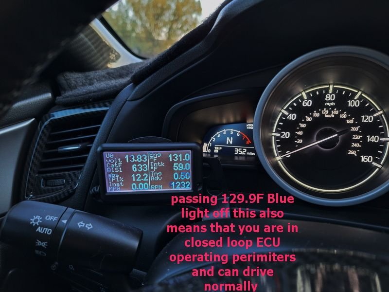

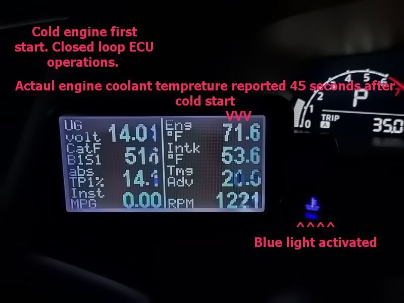

when the light goes out the coolant just reached 129.9f
If you are like me I like to know in real numbers what’s going on.

If you scan your OBDII diagnostic connector you can access true value temperature values and see by comparing your dash gauge to actual to understand what I am saying.
