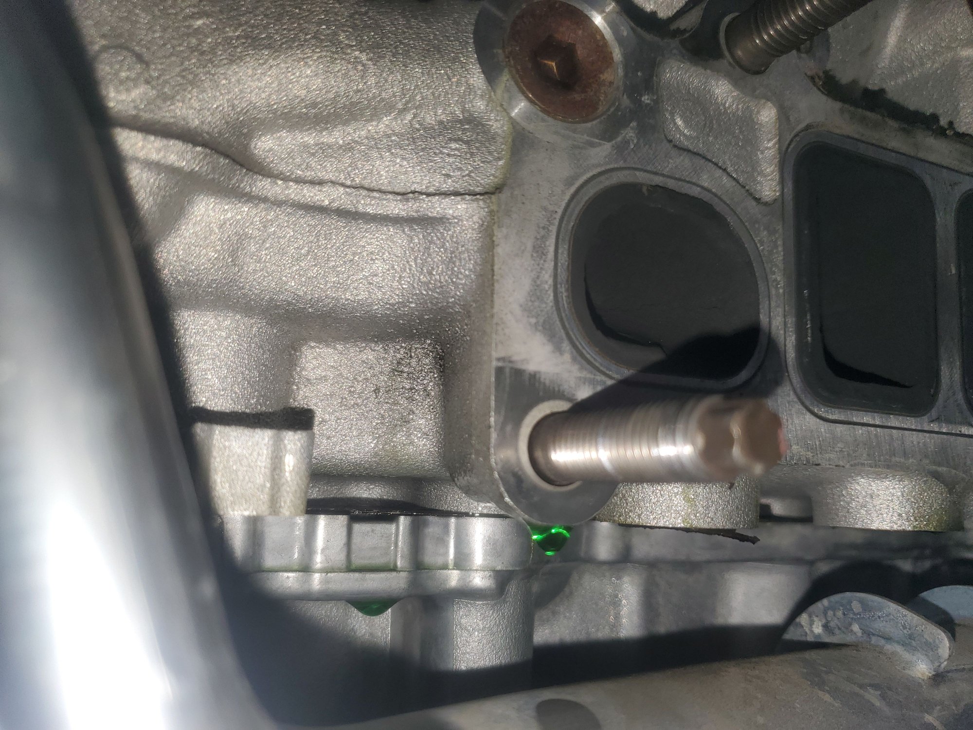

I did my first short block engine swap last week. After waiting for 3 weeks for the engine.
Story behind this job was that a customer comes in saying they overheated and everytime they add coolant it just ends up on the floor. Come to find out they had a cracked cylinder head due to the Turbo exhaust manifold getting too hot and cracking the head. And I was given an engine instead of just a head replacement due to the overheating fact. Also found the code P111A stating the vehicle had overheated.
I've only been at Mazda since about mid June last year and before that I've had minimal shop experience outside of high school and my uncles shop I used to help at. Basically only knew how to do oil changes and minor stuff. Anyway, I got mazda certified in my first month there and Sr. Certified within my first 4 months.
A couple months ago I actually did a full head replacement on a CX-5 for an oil leak from the head. But this whole swap only paid 10 hours while I had to literally take everything off of the old engine and put it on the new one. Took me about a total of 13 hours due to it being my first one and the turbos have way more **** on the engine than the na ones.
Anyway, just wanted to share that with the community. Everyone tells me how big of a job that is and that I should feel more accomplished, but Im honestly just glad to have my bay back. Instead of doing other jobs at other bays and bringing my tools. We have 12 bays and 3 techs. I wish I was able to just focus on the engine all day. But we are a small dealership.
Just wanted to share. Thought the pictures might help out or just the info itself.
Vehicle : 2017 CX-9 66K miles.
Has not been to the dealership since 2017 for an oil change but had a Warranty with a $100 deductible and got a brand new engine

Any chance you took any pictures of the new engine's head, exhaust side,? Would be interesting to see what the redesigned head looks like compared to the original design.
And thanks for taking the time and posting this. It's great information that will help many owners.
