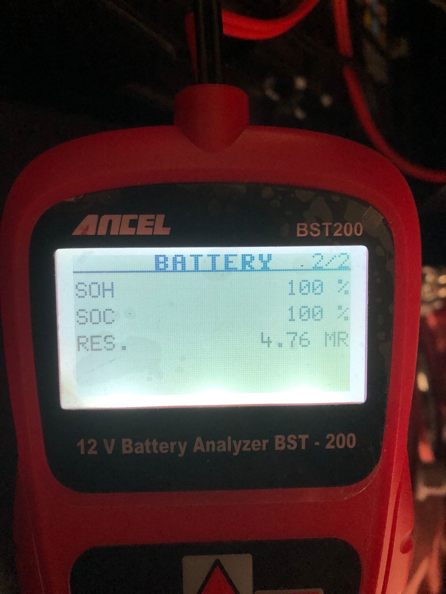

These are the readings on the battery in my newly purchased 2023 Mazda3 (vehicle production date of 12/22.
